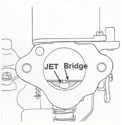

Tonight I re-adjusted the jet at the same level (picture below) than than the bridge and unscrewed 2 turns, I tried to start the engine without the starter => no flooding
I tried with the starter and had a small flooding again ... :scratchheadyellow:
So the starter/jet position with starter creates this issue. What is approximately the displacement of the jet with starter to mid or full position ?

What I usually do: 1 check if and from which overflow pipe fuel is pouring. If not, floats and valves are ok. 2 check that carbs are level, remove dome and piston of carb in question 3 remove fuel completely with clean rag, switch on fuel pump (choke off), check fuel level in jet bore- it should be down the jet approx 5mm. Fuel should definitely not be pouring out of the jet bore- in this case I decrease float height (increase fork adjustment from 11 to say 14mm- switching off fuel pump before opening the float chamber), and return to step 3. If this makes no difference at all, the jet diaphragm has to come out for inspection - together with the carb.
