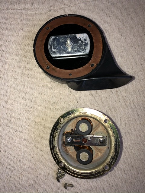

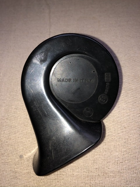

I am looking for some advice on the horns of my 1967 Series1 4.2l 2+2. They have never worked and I am looking to repair them, but first would like to establish whether the horns on the car are the correct ones (see photos).
Assuming they are original, I would like to get them working and before I check all the electrics I would like to send the horns off to be tested and if necessary repaired. Would anyone be able to advise:
1. Are they the correct horns for the car
2. Where can I get the horns tested and repaired?
Many thanks,

Is that really the correct horn...with "Made in Italy" stamped on it?....post number 33 here will help...Steve viewtopic.php?f=4&t=2007&start=20 here is a Lucas 9h
I would lay heavy odds that the Italian horn is not original. All E horns were Lucas and I do not believe any were outsourced from Italy

Perhaps a bit late to the party, but my '67 Series 1 4.2L Open Headlights has the same Italian plastic horns, only with a red body.
The brand is Stebel, model TM80.
A bit of research shows that this is a fairly big manufactorer still today.
It does seem like OE, which is hinted by the extra single hole bracket on the existing two hole horn bracket to accommodate the single bolt attachement from this horn. The single hole bracket looks not to have been added later on the car, but of course could have been there for an earlier (different) horn with one bolt.
This Stebel is a fairly modern looking unit and I wasn't yet able to find out since when they started production.
Maybe this helps.

Hi Frans...Red Italian plastic horns were not OE on an E type. ...Steve
