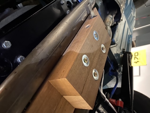

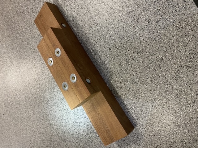

Post by Jasper013 » Sat Mar 07, 2020 4:23 pm
Decided to use some teal off cuts to fashion this pad for under the centre of the diff. Slips under the exhaust bracket to extend the end of the IRS.
Works a treat and matches the teak piece used for the front rail 😀

Post by Jasper013 » Sat Mar 07, 2020 4:26 pm
Sorry, better angle.
