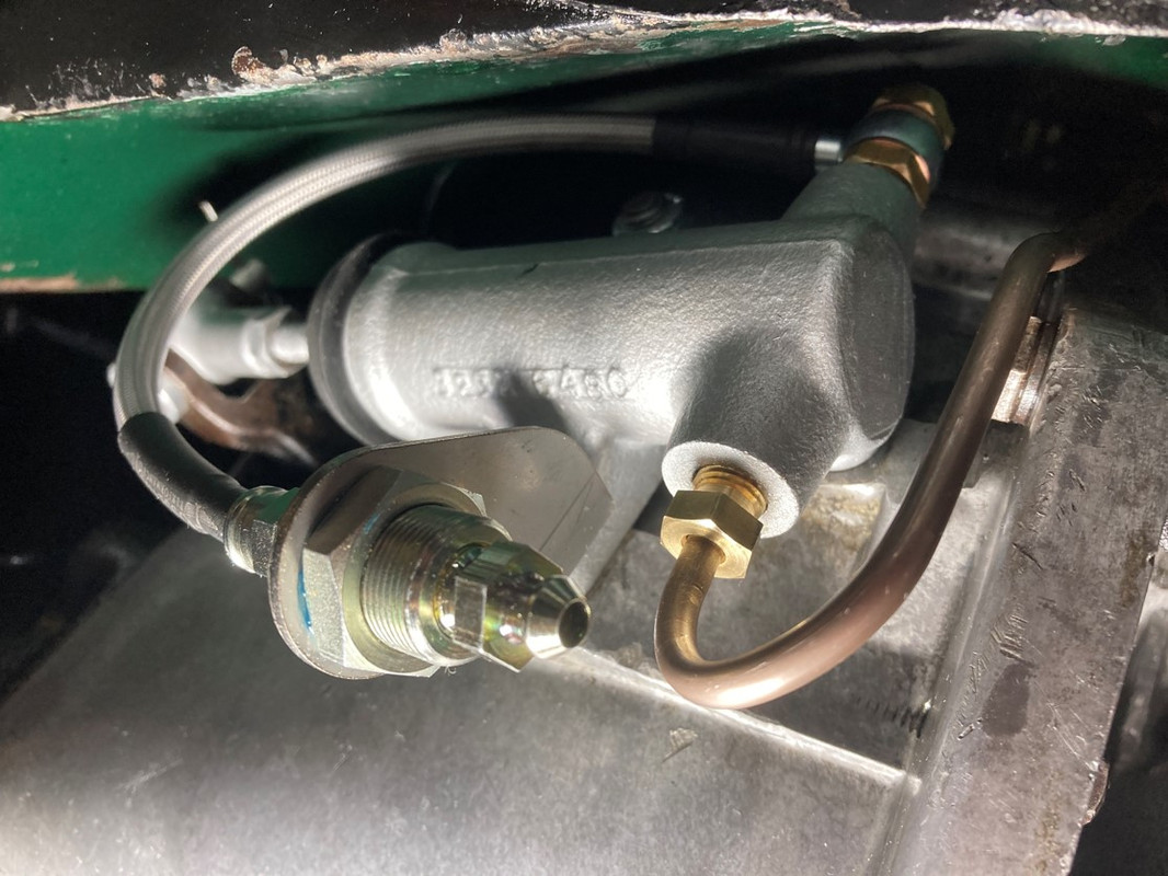

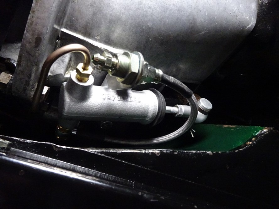

Or just change it to feed in from the bottom and out from the top :-
Cheers,
Dave
Dave Rose
1967 Series 1 4.2 FHC
Posts: 3855
#5 Re: clutch slave bleeder (top or bottom???)
Post by Gfhug » Sun Mar 05, 2023 5:11 pm
Rob Beere (and others?) have the feed into the bottom then a long bleed line to a bleed nipple on a bracket next to the manifold. Rob-Beere-racing.co.uk and look for clutch easy bleed. Wouldn’t be too difficult to make one yourself. I made a similar one to Dave Rose above.
