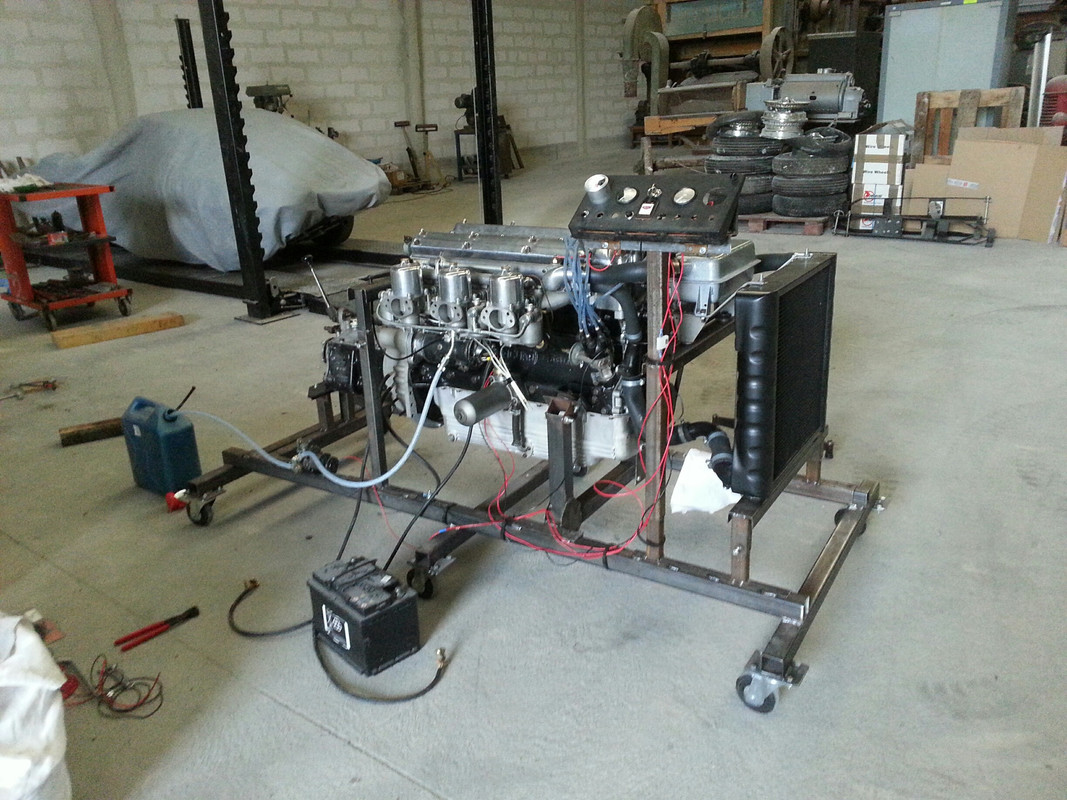

Why don't you built a mini jig to put your engine on ?
Built a small wiring.
Connect the minimum of the exhaust.
COnnect the radiator.
Connect you fuel pump to a jerrycan and start your engine out of the car.
You could also validate your clutch and gearbox.
If here is a fault you'll can repair it really mor easily.
I did that and after some lite corrections, the engine run perfectly into the car.
Mich
Michel

#17 Re: Engine rebuild - almost done!..
Post by ysmalkie » Mon Mar 16, 2020 10:29 pm
Nice one :-)
What's on the control panel??
Tadek
Tadek
Jaguar XK120 OTS
Austin-Healey 100 BN2
Mich7920
Posts: 777
Location: France
#18 Re: Engine rebuild - almost done!..
Post by Mich7920 » Mon Mar 16, 2020 10:42 pm
I bought a cheap rev conter connected to the coil
From the car I used the water temp and oil pressure dash, the power contact and the push to start the engine.
I also used a switch for an extra fan on the radiator.
Thats all
