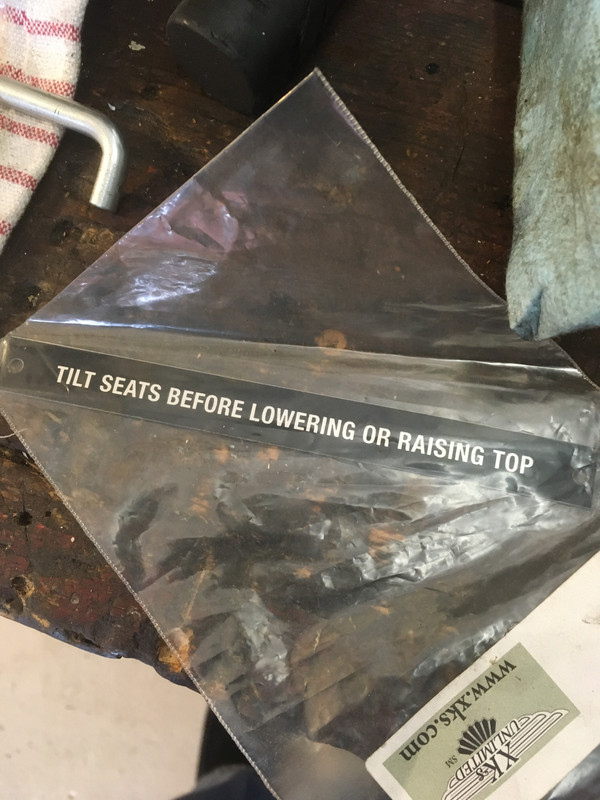

Post by keithmac » Sun Mar 29, 2020 7:02 pm
Hope you are all keeping well. Can't find a clue where to attach this. :questionmarks:

#2 Re: Where does this go?
Post by myharris » Sun Mar 29, 2020 9:58 pm
On convertibles, it goes on the headlining above the windshield

#3 Re: Where does this go?
Post by keithmac » Sun Mar 29, 2020 11:02 pm
Thanks !
Wood screws in , I imagine

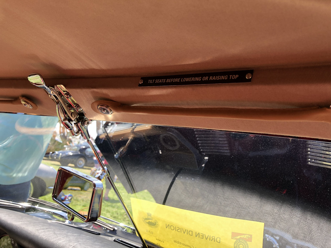

#5 Re: Where does this go?
Post by SpeedieJag » Mon Mar 30, 2020 5:57 am
Here's a photo of the placard on a friend's car. He has an early 4.2 car which precedes this placard but I couldn't bring myself to tell him as he just had a new soft top installed. :?:

#6 Re: Where does this go?
Post by Philk » Mon Mar 30, 2020 8:26 am
Would this have been "sided" - i.e. it would have been fitted above whichever side the driver was seated and therefore different from LHD to RHD?

#7 Re: Where does this go?
Post by grimes6 » Mon Mar 30, 2020 10:35 pm
Always on the RHS.
