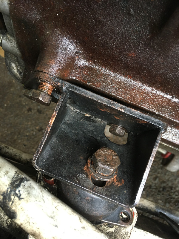

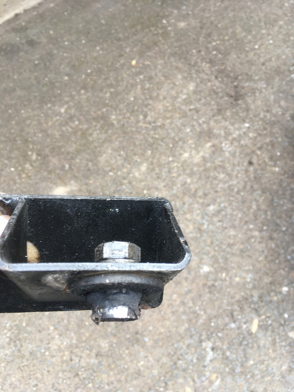

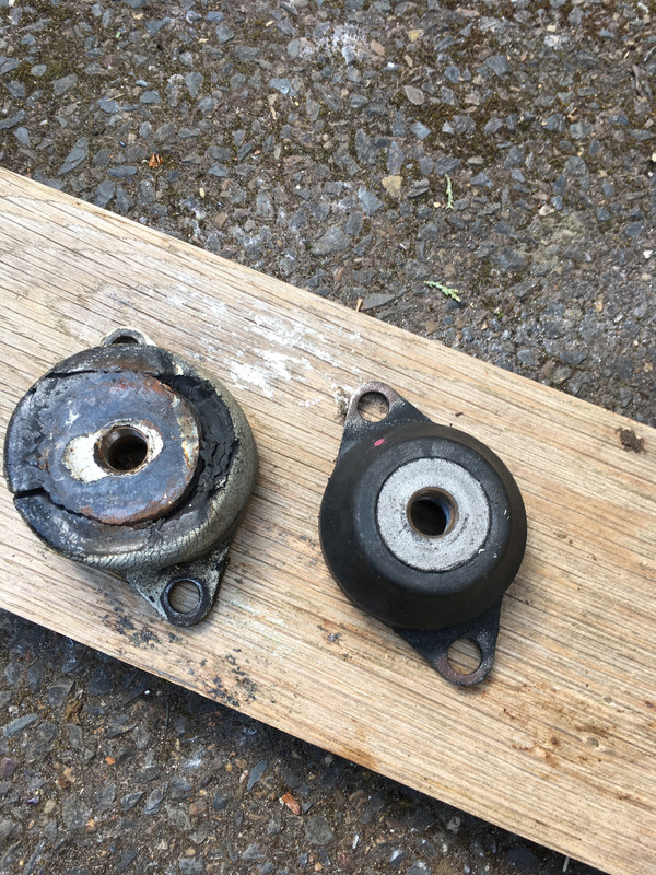

#7 Re: Engine mount torque settings
Hi Guys
Well that was a bit of a job! Although they aways are ....
After cutting four bits of 8 x 2 to raise the car high enough so I could get a jack with wood on it underneath to support the engine whilst I undid the mounts.
It’s obviously very fiddly but do able , the right hand side went very smoothly although it was completely shot but the left one rubber part decided to just disintegrate, which meant the metal threaded centre just went round and round.
After trying mole grips and even lowering in back down to put weight on it I finally decided to take the whole metal mount off, again a pain to get to but after some perseverance I finally got it off then had to put it in the vice to separate them.
Then the same all in reverse with a few grazed knuckles it’s back on its wheels and tightened up to just under ft!
All in all a tough but do able job that was very needed and satisfying to do .
Thanks again for all your input
I hope this may help the next person
Grant
