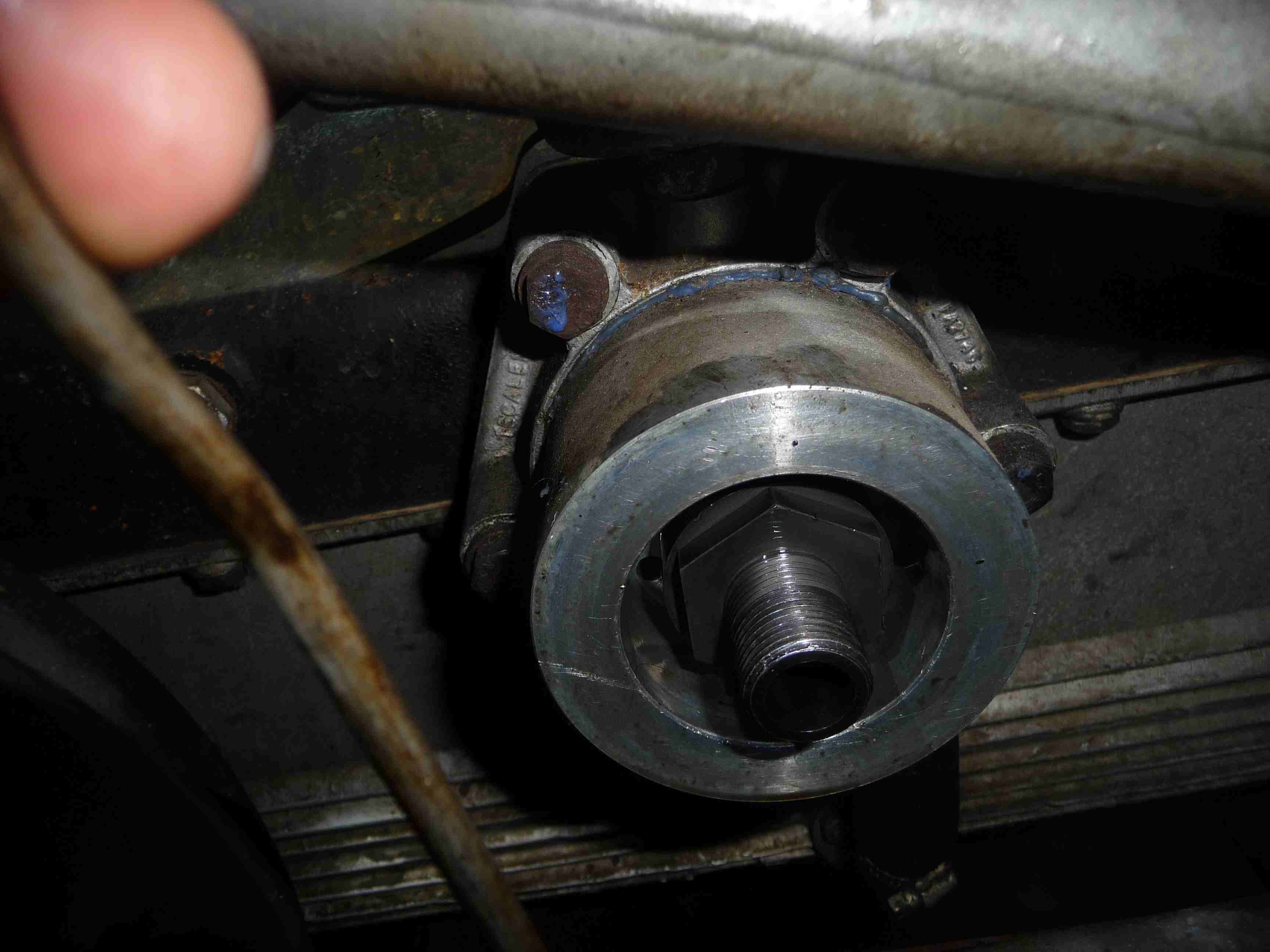

Hi all,
To perform an oil service on my 3.8 FHC, I sourced a standard EBC 9658 Jaguar oil filter that should fit on the oil filter housing that was already installed on my car when I purchased i:
To my surprise, I discovered that the Jaguar oil filter could not be installed.
The old oil filter is of a smaller size than the Jaguar one, and more worrying, the diameter of the threading to attach the filter to the housing is of a smaller size than the one needed by the Jaguar filter.
Apparently the current (smaller) oil filter was installed during the last service.
I am concerned by the possibly smaller oil flow permitted by the previous smaller oil filter.
I have now two options:
- replace the present oil filter housing with a conversion kit as the one sold by SNG; or
- source an oil filter with a smaller threaded hole that may be screwed on the current housing (my preferred option).
What is your advice:
Are there good enough (high flow) oil filters with a smaller threaded hole that may fit the 3.8 engine (if so, which ones)?
If not, and if better to replace the current filter housing, is this a simple job (the access looks to me quite uneasy and the bolts may be seized...)?

I have considered more in depth the options of a suited spin on oil filter or of retrofitting the OEM filter system.
First, I am a bit lost with all the offers of spin on filters, many brands, many models in the brands, and no easy comparaison of the specs, especially concerning the flow, return valve or not, capacity and filtration.
I understand that my current system is of the 3/4"-16 thread type while the Jaguar spin on conversion kit is of the 1"-12 thread type to host the EBC 9658 system.
The filter that was mounted on my system is a Crosland 529/1. I hope it had specs adapted to the 3.8 engine, especially concerning flow, pressure, filtration and return valve.
Actually I did not notice any specific issue regarding oil pressure, the numbers shown on the dashboard gauge being in the standard range during driving and idle, engine hot or cold, with 20W50 oil.
Andrew, your message was a bit cryptic, can you confirm that the filters you recommend are of the 3/4"-16 type and are they all as good and well fit for the XK engine or are there better choices (any preference)?
Stuart, I agree that my glued/bolted filter housing looks "amateurish".
Regarding the possibility of retrofitting the OEM system, it seems that NOS or remade parts are very difficult to source, see e.g.:
https://www.sngbarratt.com/English/#/UK ... mbly/21231
And used complete assemblies rare and quite expensive, e.g.:
https://www.ebay.co.uk/itm/JAGUAR-E-TYP ... SwzOleoD7D
Fortunately, it seems that the main housing on my engine is original or original/compatible with the correct ductings as it is a Tecalemit FA2746, so that I should only source the filter canister, bolt and smaller pieces (spring, washers).
There are a few NOS canister housings currently for sale on ebay and the other parts may be sourced from the usuals:
https://www.ebay.co.uk/itm/JAGUAR-E-TYP ... SwPCtdA9Xr
I have also checked that although access to my current housing in the engine bay is acrobatic, the retrofitting job may be doable, the main bolt being apparently a 1 1/4" that I could move when using a 32 wrench pipe (I didn't have an imperial wrench pipe but 1 1/4" is 31.75 mm, so very close to 32).
So that retroffiting becomes a serious option!
I'll dig further.
Thx again for your contributions and help.

I have finally decided to retrofit, convinced by your arguments about efficiency of the OEM filter in terms of flow and filtration.
It seems to me that dismantling the current assembly and reassembling all the OEM spring/washers/bolt/canister in a place of such a difficult access will not be easy and was not that well designed by Jaguar...
