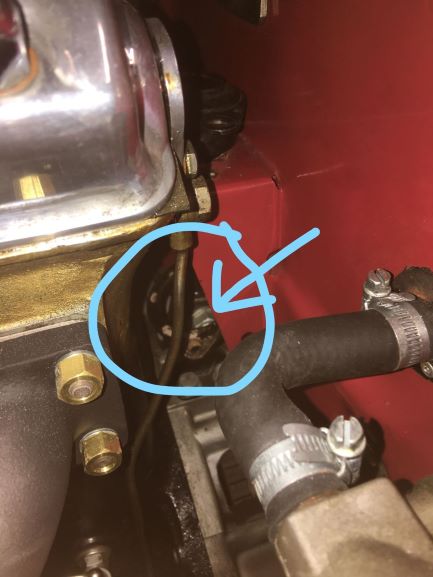

#12 Re: Driveline clunk
My stabiliser mount was bolted to a thick (^6mm) plate underneath the bulkhead bracket. I've circled it in this photo - it's quite hard to see as its resting on the bottom of the stabiliser rod which I haven't taken off hence not being able to remove the plate.
I ask as I can't see any reference to this plate in the parts diagrams - just checking it's not some sort of modification for strengthening

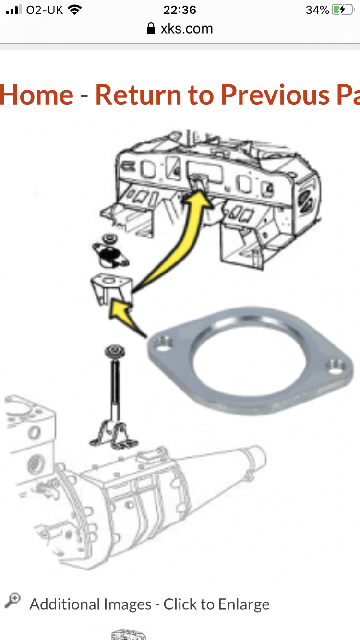

#13 Re: Driveline clunk
I don’t think there should be any parts to that assembly other than those in the pic below.
If there are, it sounds like a p.o ‘fix’ for something!
#14 Re: Driveline clunk
Interestingly I think I have now estabilished it is a bone fide part C21201 'tapped plate' eg
https://www.etypeparts.com/c21201-e-type-tapped-plate
But I'm curious it isn't shown in most diagrams including the one you've highlighted,
I wonder if this is a mid production spec change. Anyway I'm hopeful that the clunk is the noise from the adjustable lower washer hitting this plate as the new engine mounts have settled a mm or two - makes sense & i'll be able to establish when the new mount arrives
