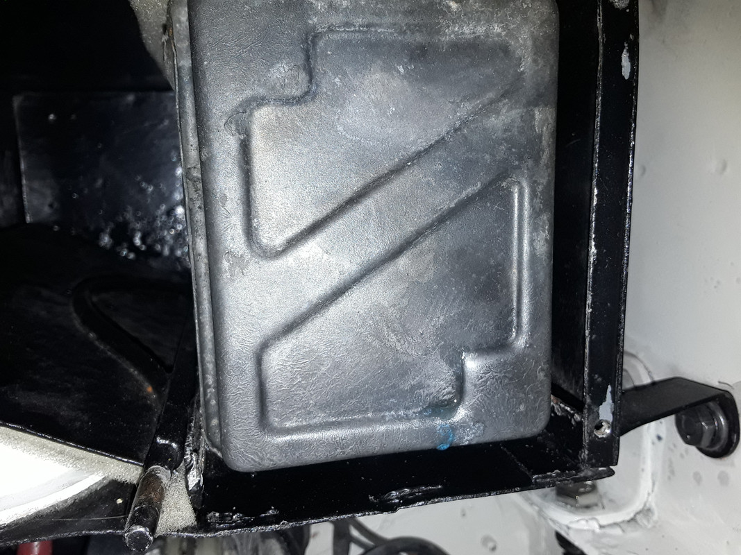

I noticed a small amount of coolant had leaked out of the heater box and on investigation discovered that coolant was seeping out through the end panel of matrix. See photo:
Any suggestions as to what would have caused this leak and any advice on if its possible to fix.
Ian

Hi. Sadly I suspect you will find the leak comes from the heater matrix exchanger within the heater box....essentially a small version of the car radiator (not a radiator at all but a best exchanger but that's another story). Probably uneconomic to repair the existing exchanger but they are available from the usual suppliers. You will need to drain a couple of pints of coolant out of the system (or drain the lot and renew), remove the end panel of the heater box, disconnect the hoses to the matrix (probably replace them too)...and then the matrix can be slid out. Sadly chances are the leak has caused rusting inside the heater box so a good time to clean up and paint in there while you await delivery of the new unit. Fitting is the reverse procedure....a not difficult task at all. :bigrin:

Perhaps order some new foam that goes round the matrix and stops it moving about in the box. Again available from the usual. I know Barratts do it as a kit. While you have the heater box apart check the foam seal on the internal flap. If this is damaged or missing you will get reduced air flow through the matrix.

Indeed....once you open the heater box you open a can of worms....you may wind up restoring the entire car again :bigrin: :bigrin: :bigrin:

And if your brave enough give a close up check to the bulkhead pipes!

I've removed the old heat exchanger which was in a pretty sorry state so I've ordered a new one from SNG. The inside of the heater box was in pretty good condition but I have nevertheless sent it off to be powdercoated. I had replaced the insulation around the exchanger a few years ago so that doesn't need replacing.
