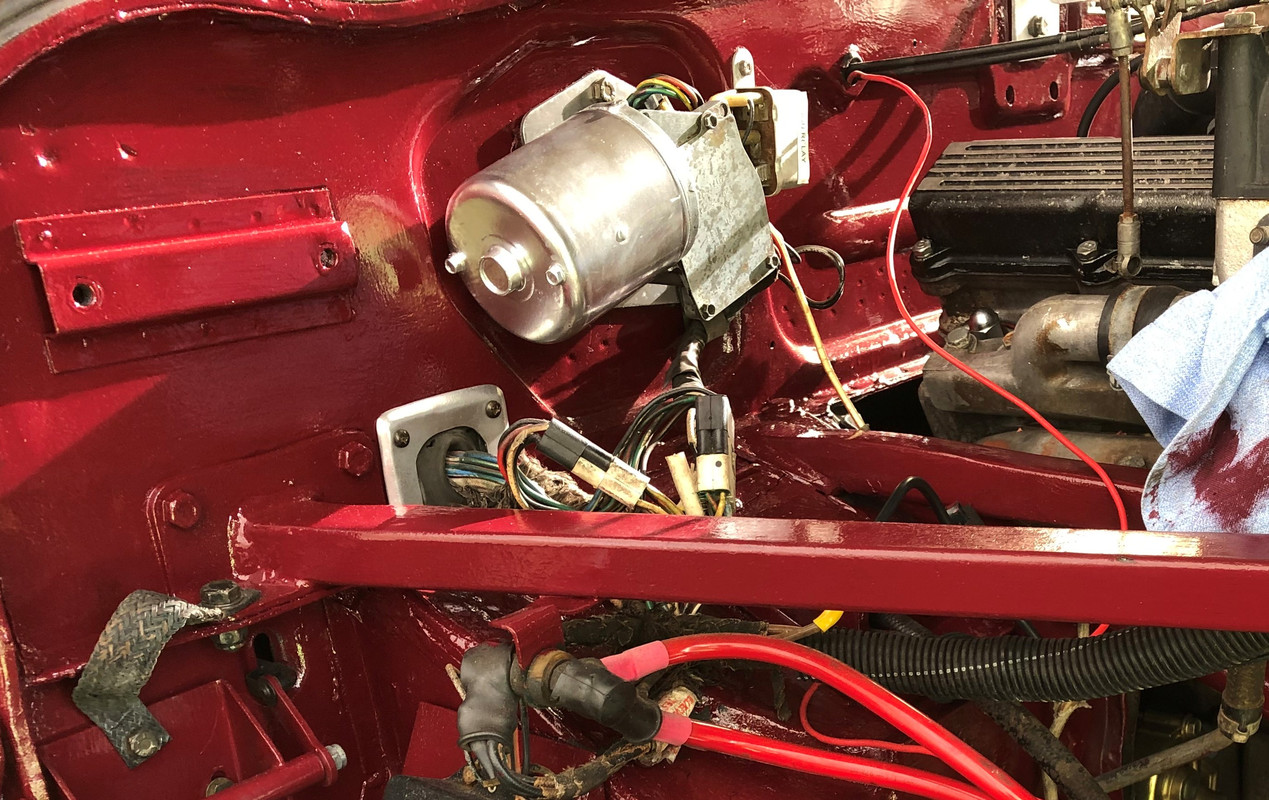

I have a Series 3 E type V12 roadster I’m having problem on which side the engine harness comes from the bulkhead. The bulkhead Loom plug to the engine loom is on the n/s but been told it should be on the o/s. This is a right hand drive car.

It just so happens we have two S3's in the workshop. They both come through on the offside (R/H) of the bulkhead just below the wiper motor and bottle bracket.

This photo may help.
