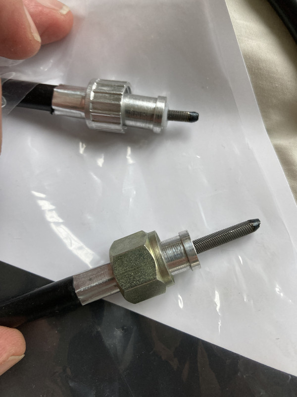

#4 Re: Speedo not working
Hi Christopher (and possibly others...). Well I had a look at the inner cable and there is about a half inch protrusion at the speedo drive end. It would therefore appear, as I had assumed, that the inner cable is simply not connecting inside the drive, presumably because it is too short.
Is it possible that the inner cable is fitted the wrong way up, so to speak? I presume that the only way to tell is to take the blasted thing out again which, as most people will know is a pain! Or could it be that the cable itself is faulty and a new one would cure it (although the original came from a well known supplier. (with initials in its name!) and was stated to be for a 2+2 as it is longer.
I attach two photos (I hope) which might be of assistance.
Many thanks for your advice.[attachment=1]47D16CC0-30AB-4757-9DA9-B1273D043D19.jpeg[/attachment]

#5 Re: Speedo not working
Malc : are those pics of the 2 different ends . If so , it looks to me as though there is something most peculiar happening, because you look to have a speedo type attachment at BOTH ends. The gearbox end from recollection should be a large brass female threaded cap , and I'm pretty sure that the gearbox end should just be plain inner cable with the squared off end to fit into the angle drive. Unfortunately I've not got a spare to illustrate this
#6 Re: Speedo not working
#7 Re: Speedo not working
Hi Christopher and Richard - thanks for your notes. The two pictures are both of the gearbox end. As far as I can see from various pictures of the cable I’ve looked at on suppliers’ websites, one end has a knurled nut and the other a square one. The knurled one presumably attaches to the speedo (I can’t remember now as I fitted it a couple of years ago) as it can be tightened by hand. The gearbox end can thus be tightened by spanner (or pliers).
Looking at the picture of the cable posted by Richard from Speedograph, appears to confirm the above but it is also apparent that the inner cable at the gearbox end protrudes a lot more than on mine, so this does appear to be the problem.
I am going to have to get the cable out and have a look to see why the inner cable does not protrude more and if necessary buy a new one - from Speedograph,
Ah well, better get my fingers pliable....
Many thanks for the advice.

#8 Re: Speedo not working
The cable in the pic was damaged during manufacture, it had a kink in it just below the plastic ‘stop’ at the speedo end. So if ordering from Speedograph, check it carefully before fitting!

#9 Re: Speedo not working
Hi Malc...the inner cable pulls out from the speedo end....so if the outer sleeve connection isnt fitted correctly and fully screwed into the speedo then you could be short on the inner cable at the gearbox end...Steve

#12 Re: Speedo not working
Hi all - problem solved! The cable was not sitting flush at the speedo end - I suspect that the knurled nut was slightly cross threaded so did not seal properly hence the other end was short. I undid it and played around again with the drive end, pulled the inner cable through and connected it to the drive and spun it with a drill and, hey presto, the speedo worked. So I then spent a while trying to get the blasted thing connected again at the speedo end and eventually it spun on easily and did up tight and when connected to the drive, it still worked. Drive now back in place so all is well.
