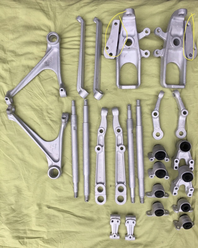

Hi gents,
A little bit each day, no matter how small. Some progress with the front suspension. Upper wishbones being sent for nylon cup upper ball joint fitment. The upper fulcrum shaft inner washers on mine are countersunk. Correct?
If so, does it sit against the shaft or the bush? I didn’t pay enough attention when I dismantled them.

by Robbiee
Your picture shows a couple of brackets, maybe related to fitting brake calipers ? I’ve not seen them before and certainly not on either of my S1 cars.
They’re the ones I’ve highlighted on your photo
Can you enlighten me please?
Robbie

Hi Robbie,
Yes, you’re correct, they were modified to fit S2 callipers sometime before my ownership.
