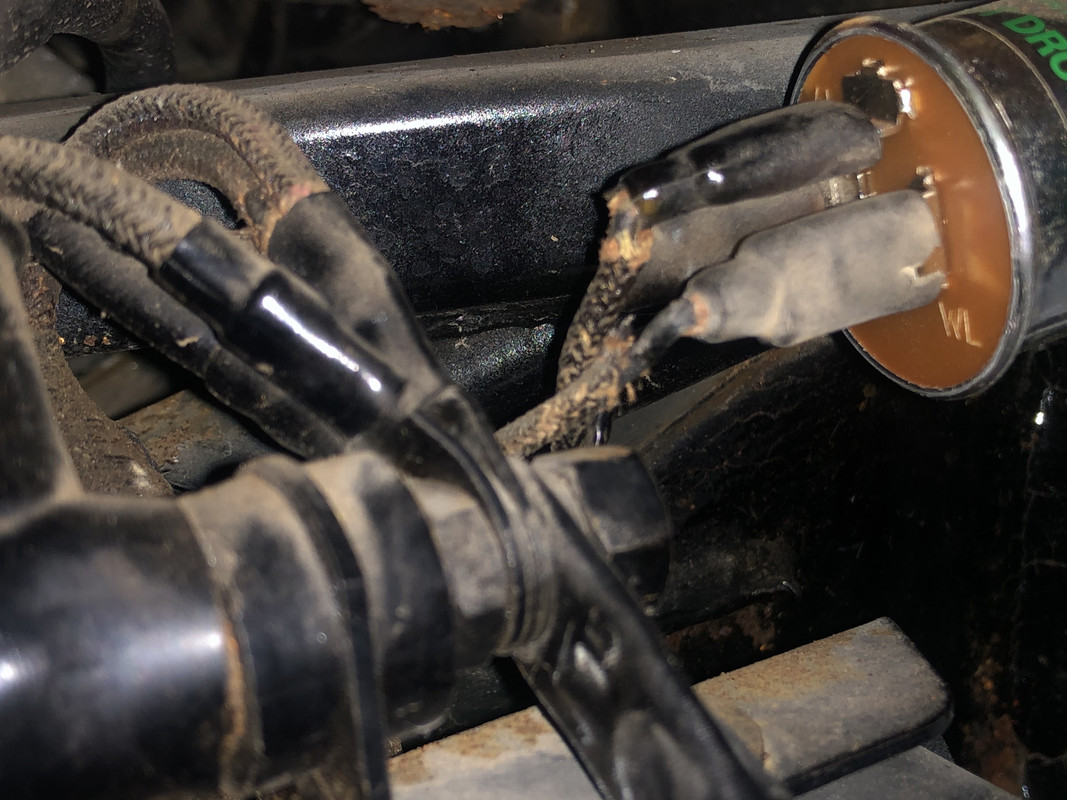

I am having problems getting my lights working again and I dont seem to have power going to the fuses. I wondered if this might be the culprit?

I very much doubt it could be. This is the 3aw relay that simply drives the ignition light only. Good luck with your investigations
