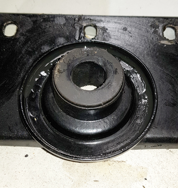

Hi Mich....are you missing the lower rubber mount here is a photo of mine the rubber comes through the plate like a large grommet .....sorry photo is dark try to add brightness....Steve

Post by Mich7920 » Tue Sep 08, 2020 9:45 am
Hi Steve,
Sure I didn't do that !!!
Of course my axle hurt the support without this "grommet"
What Is the page of the manual that I miss ?
And what about the very compress spring ? Is it normal ?
Thanks a lot. :bigrin:
