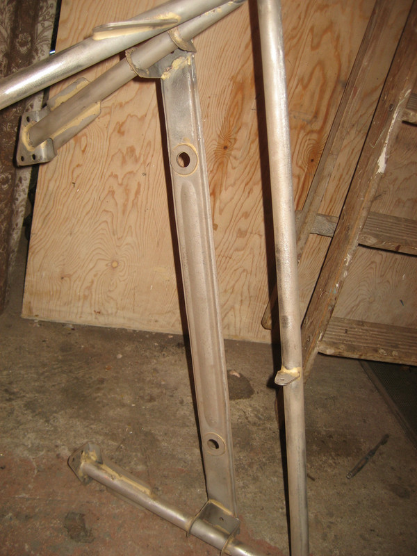

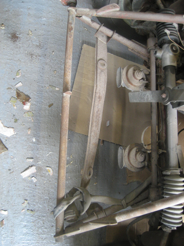

Joes66
Posts: 315
#8 Re: Radiator mounting panel
Post by Joes66 » Fri Oct 23, 2020 8:09 am
Thanks Paul
Yes I was thinking I may be able to repair it
But after looking I don't think it can be taken of the frame
Its in poor shape as I think someone must have hit something that was sticking up or tried to jack it up on it or something
Its also no longer brazed to the rest of the frame
I suppose I could cut it off and try and restore it and then weld it back on
