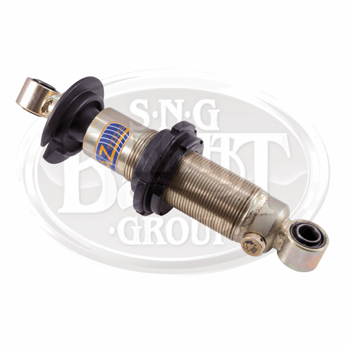

Hi Joe...do these look like your shocks...they are from SNG website that they said needed the shorter spring...Steve

Yes that looks like them
But its not easy to tell
The car sits fine so I don't know about the shorter springs thing

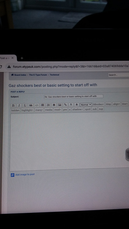

Hi Joe....when you post or reply you should see highlighted at the bottom "add image to post"..click this then select your image....Steve

Nope
Nothing there

That is simply not on my screen
And i can't see it anywhere else
At the top of my screen I have a different set up with lots of smilies etc

maybe its because I am using my mobile?
