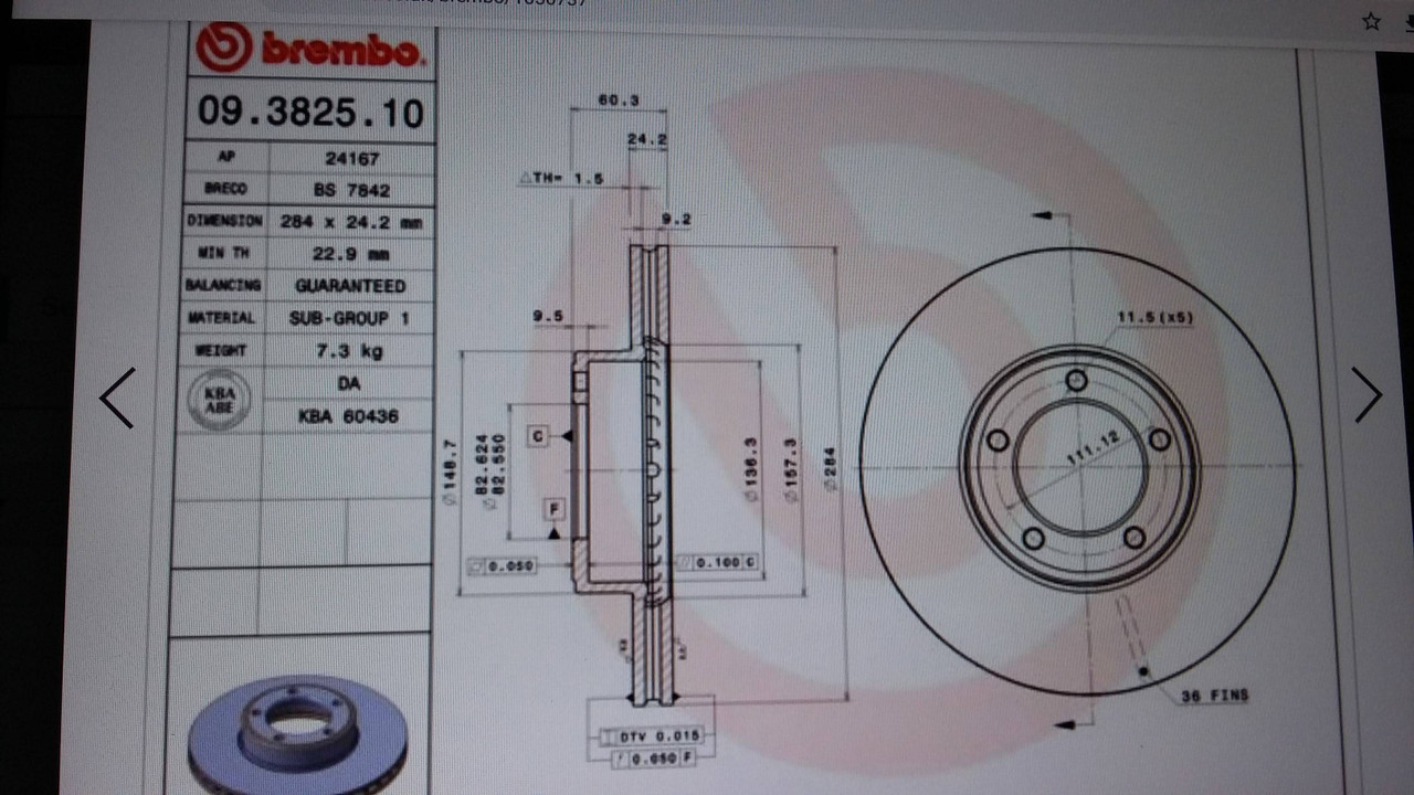

Hi Kevin if you search on the large brake manufacturers you can find tech drawings of thier discs i looked up these the other day...think they are S3 xj6....but at least you can search for the ones your after or call their tech team to discuss.....Steve

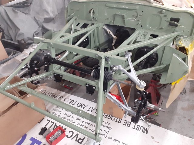

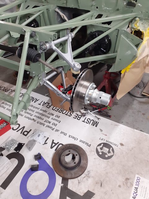

kevhillyer
Posts: 25
Joined: Wed Sep 25, 2019 4:43 pm
Location: Chichester, W Sussex
#9 Re: Help needed to find correct ventilated front brake discs
Post by kevhillyer » Thu Nov 12, 2020 10:03 am
What a great forum, under 24 hours and already some really helpful comments, thank you all.
I have someone working on the car and perhaps I have misunderstood about the callipers - I shall investigate that more today.
Here are a couple of photos to show the area in question. I shall see what can be done to move things back towards a more standard set up.
Hoping to resolve the issue before the end of the week - will keep you posted.
Many thanks again
Kevin
Kevin
1970 S2 2+2 Manual

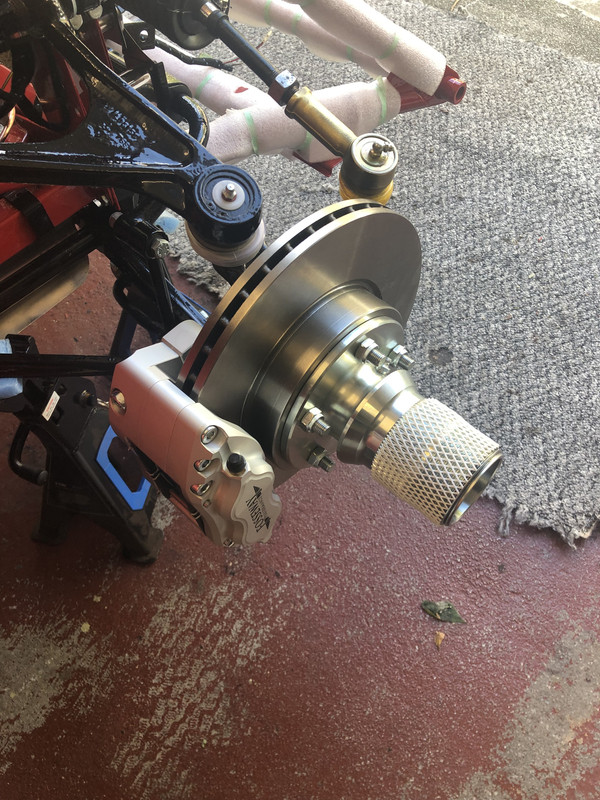

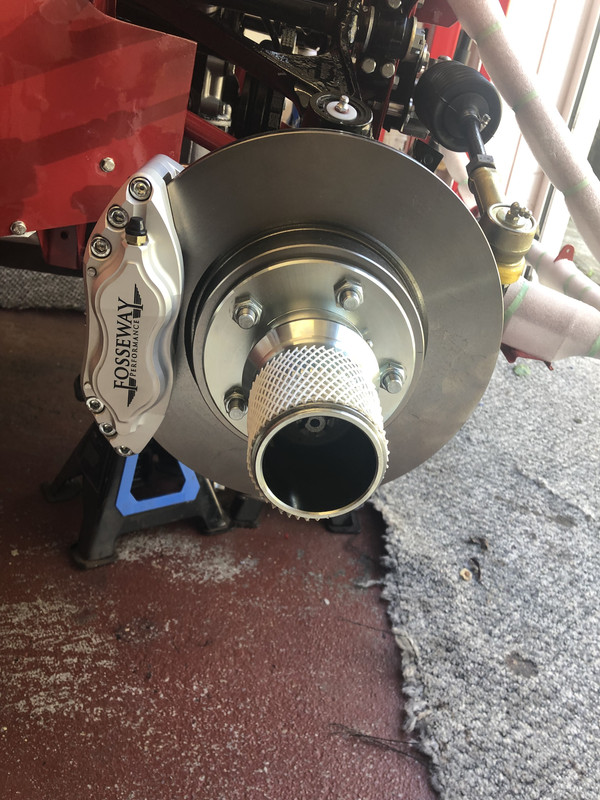

Post by AshM » Sun Nov 15, 2020 5:40 pm
Hi Kevin
Another option to consider.
I have fitted vented discs and callipers from Fosseway Performance on my S2 and absolutely delighted. Perfect fit and the brakes are much improved. I have a number of reversible mods on my S2 from Fosseway as I am a big fan of their product quality.
But appreciate it is not original (but 100% reversible).
food for thought...
cheers
Ash
