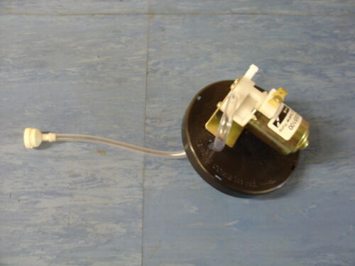

I also had a problem with the washer on my '69. The nice thing about this model is that there's a plastic cover which hides the actual pump. If you carefully disassemble the cover, you can remove the Lucas pump and fit a generic part from your local parts store. As long as it fits under the cap, nobody will know the difference. I'm not sure what's available on your side of the pond, so I don't have a specific model part or manufacturer to recommend. But bring it to your parts store (Halford's I guess?) and see if they have something that could be shoehorned into place.

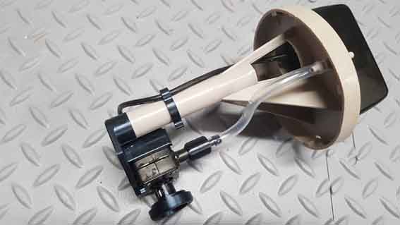

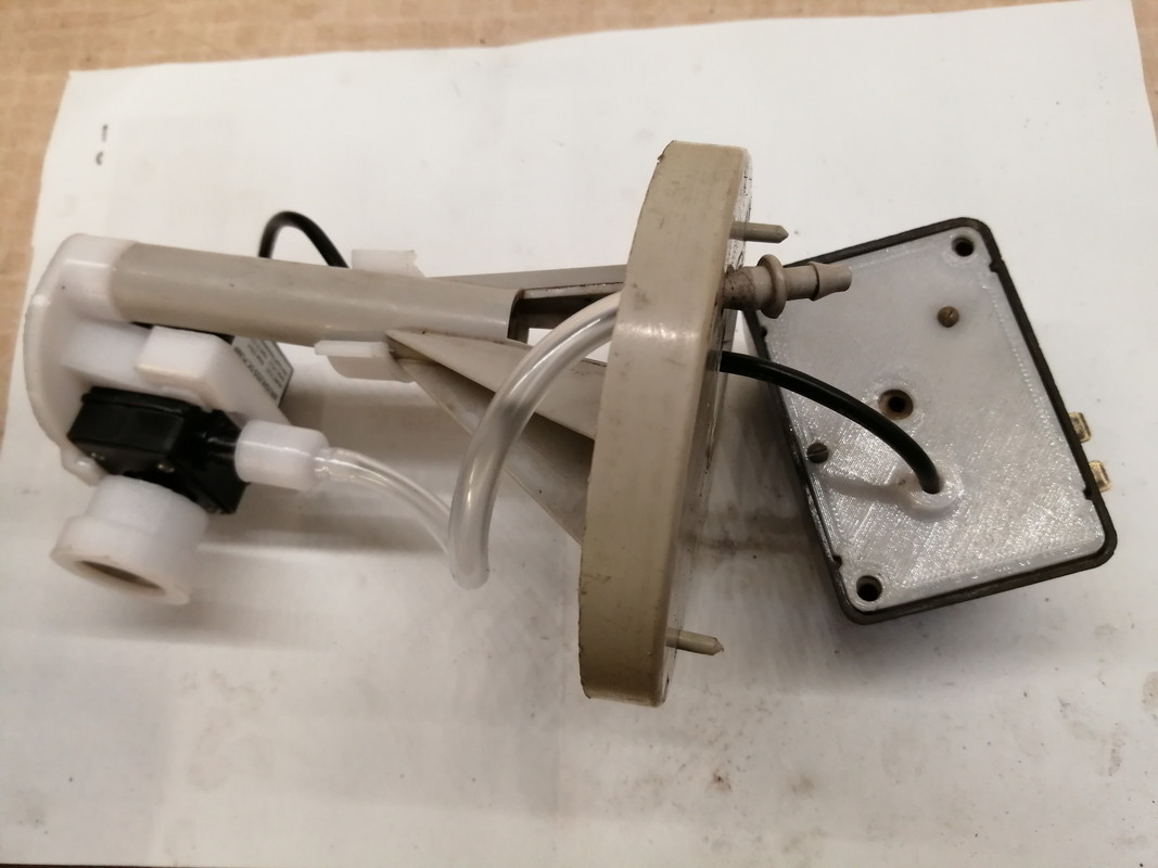

Interesting, as I've just been working on a solution to improve the woeful performance of the Lucas screenjet pump for when my car returns from restoration. I had an old unit, and the motor internals were badly corroded in any case. I sourced a 12v submersible pump online for around 6 GBP, and design and 3D printed a small kit of parts to mount this onto the bottom of the existing washer bottle pump lid. I removed the Lucas motor workings and simply connected the new pump leads to the existing terminals. Everything is completely hidden from view. The Lucas pump is rated at 12.6 l/hr, and the new unit is 240 l/h, so my only issue could be too much flow - however, testing with a 12v battery shows that it looks to be a great improvement, but not over powerful for the existing system, so perhaps the quoted flow is a tad optimistic.

Seem to have the same problem with the washers on mine. Pump runs, but not enough water coming through and I've already stripped & and cleaned the motor parts.
Has anyone swapped for this type using the WSB100 pump? Just wondered if it's much better and whether the old cover will fit over the pump as per Mike's suggestion?

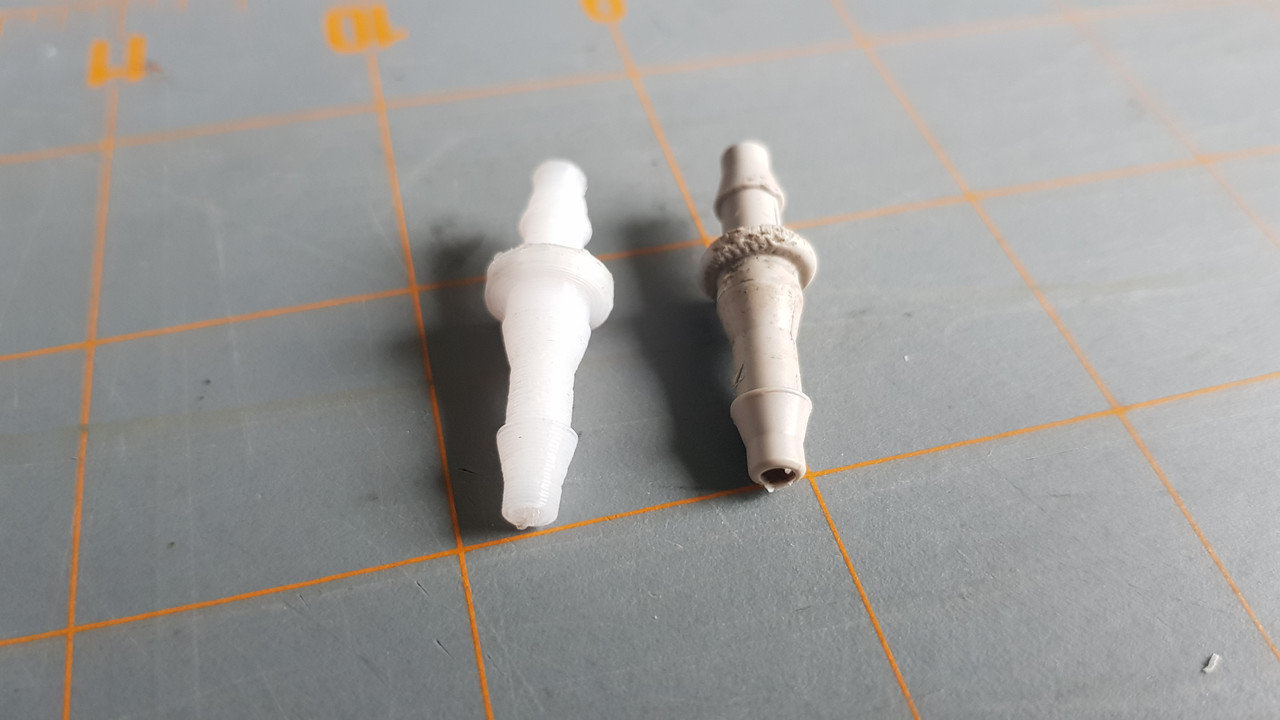

On the subject of these water bottles, mine looks
like it can be rescued. The bottle and lid are scuffed and may need some gentle heat to ease some dents out, but overall it doesn’t look to scruffy. But rather irritatingly the little fitting that allows for the liquid to traverse the lid is missing. Anyone got a good idea of what to replace that with?
I bet there is something out there (aquarium related etc) that might do the job. Anyone been here before?

Are you up for producing more of your kits, Richard??? Could be plenty of customers if it works well, so put me down for one.Monkeyfinger wrote: ↑Sun Nov 15, 2020 4:18 pmInteresting, as I've just been working on a solution to improve the woeful performance of the Lucas screenjet pump for when my car returns from restoration. I had an old unit, and the motor internals were badly corroded in any case. I sourced a 12v submersible pump online for around 6 GBP, and design and 3D printed a small kit of parts to mount this onto the bottom of the existing washer bottle pump lid. I removed the Lucas motor workings and simply connected the new pump leads to the existing terminals. Everything is completely hidden from view. The Lucas pump is rated at 12.6 l/hr, and the new unit is 240 l/h, so my only issue could be too much flow - however, testing with a 12v battery shows that it looks to be a great improvement, but not over powerful for the existing system, so perhaps the quoted flow is a tad optimistic.
[/quote]
Geoff - I hadn't really considered this as more than useful information for others, but it's certainly possible. I could have rigged up the motor with cable ties and sticky tape, but I'm lucky to have a 3D printer and the necessary skills, so I though I'd try for a more engineered approach. If your interested, then by all means send me a pm and we can discuss. To be honest, it does need final testing on a car, and I'm a little way off that capability myself right now. However, I think this brushless submersible motor is significantly more capable than most of the standard style washer pumps, and also practically silent when running.

Rich - I have 3D modelled and printed this part. If you're still after one, then by all means drop me a pm.(new part on the left!)Richardhealey wrote: ↑Tue Nov 17, 2020 5:23 pmOn the subject of these water bottles, mine looks
Cheers,
Rich

Big thank you to Richard (Monkeyfinger) for producing an alternative pump kit that fits inside the original S2 bottle & motor cover. It's been tested on my Series 2 LHD coupe and, with the added help of a non-return valve in the pipe near the bonnet hinge, gives a good supply of water out of the twin centrally mounted jets.
