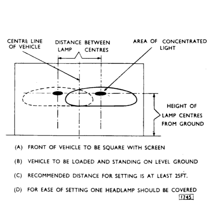

I am adjusting the headlamps level after fitting new bulbs. Can someone tell me the level of the light on a wall in front of the car ? i can have no more than a distance of 8 meters between the car and a wall .

The service manual gives this guidance:
It doesn’t give heights as I guess there may be variances, but the starting point seems to be the lamp centres.
I didn’t have 25’ of level ground so the MOT guys did it with their tool in about 5 mins!

Post by Polse7317 » Fri Dec 11, 2020 10:49 am
Thank's Richard it's exactly what i need .... I should have read the manual before... :oops:
