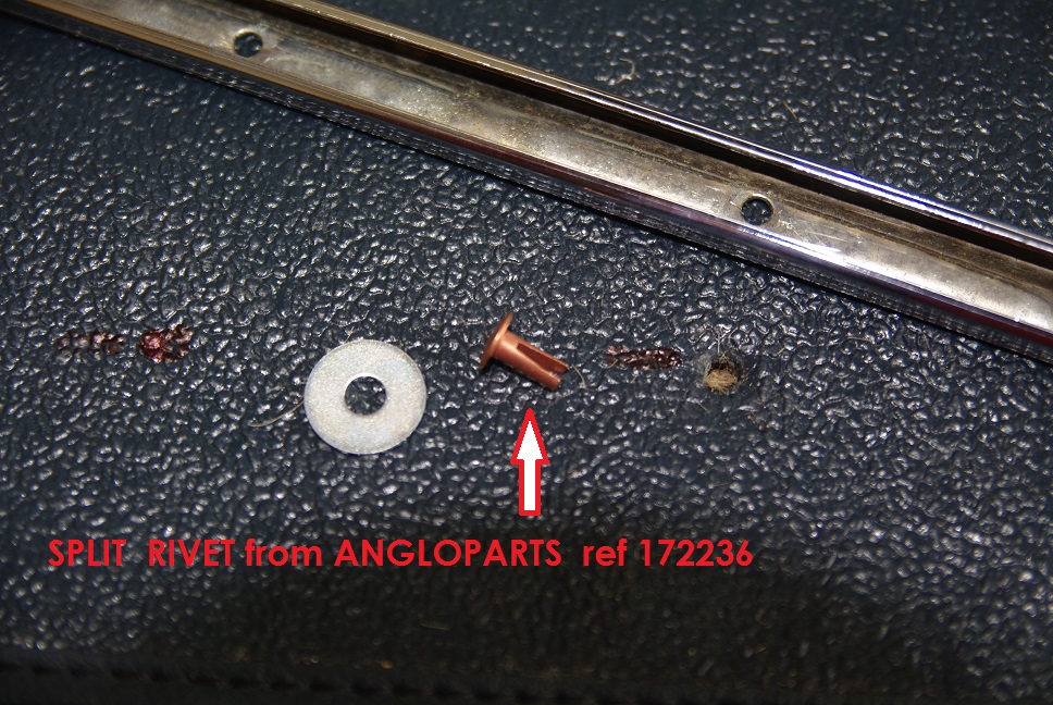

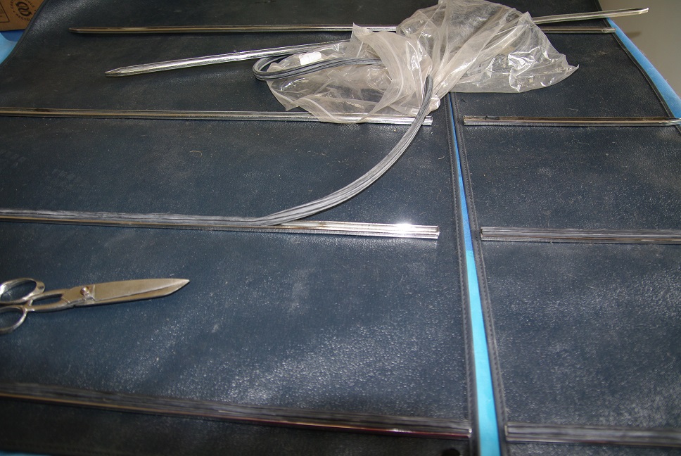

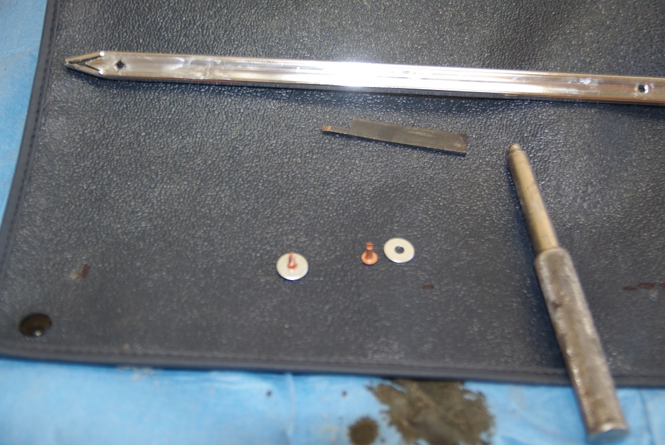

Regarding the attachment of the rails on the hardura mat: can simple pop rivets be used?
Also form what I noticed in painful taking off the old cracked rubber strips, is there a tip to insert the rubber once the rails have been riveted to the mat?
Serge

#11 Re: Boot board rail rubbers
Post by Joes66 » Sat Dec 12, 2020 7:04 am
Thanks for all your replies
Going to just order the SNG rubber I think
And those split rivets
Joe

#13 Re: Boot board rail rubbers
Post by paulsco » Sun Dec 13, 2020 10:53 am
Yes, the bifucated rivets are used on early cars where the runners are riveted to a mat.
The later cars where the runners are fixed to the boards have self tappers.
