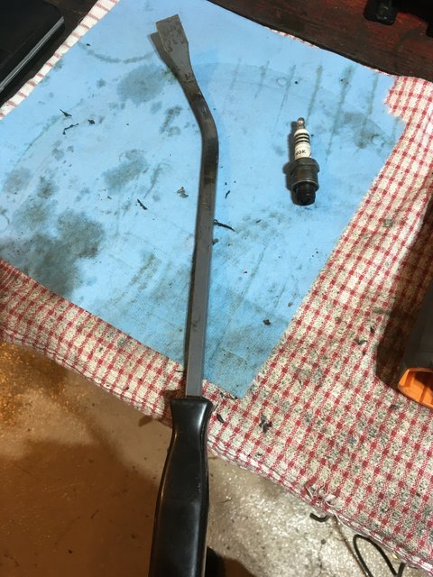

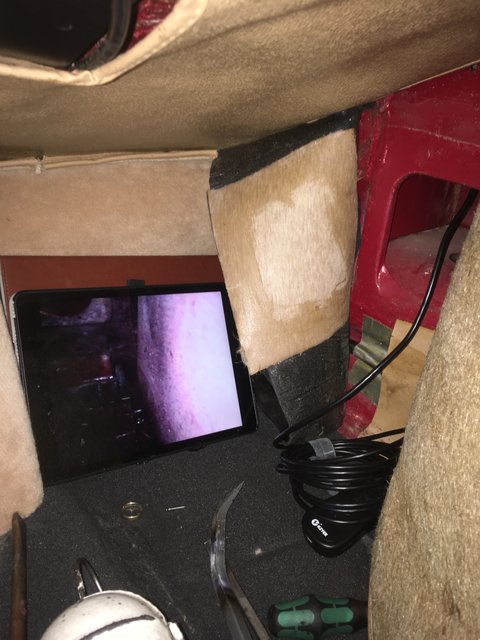

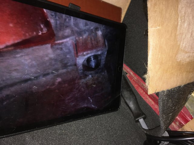

First, get your endoscopic bluetooth camera and your iPod
Then get a medium pry bar, torch it till you can bend it

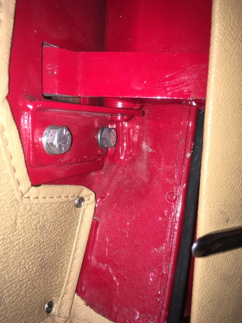

Get in there with the pry bar while watching the pry bar placement on the camera. Jam the weakened cage against the nut, remove bolt , chase thread, lubricate, replace bolt, jam cage against nut while tightening bolt.
JOB DONE!! YEEEHAAW
Love these minor triumphs.
Weakened cage bent back into position
