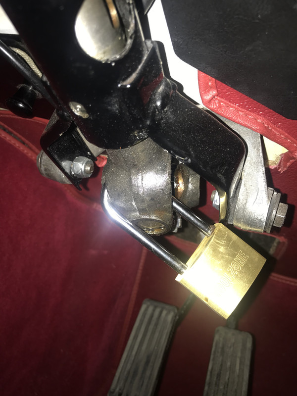

A quick and easy steering lock can be created by using a pad lock through the steering column universal joint under the dash.

Post by Paul bow » Sun Jan 24, 2021 4:08 pm
That padlock is quality!! 😭😂😂😂😂
