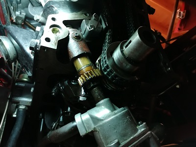

Now you have to put the crankshaft in the right position so that it does not interfere with the removal of the oil sump.
6- On the photos below, you need to find your way around the position of the key locking cone to damper.

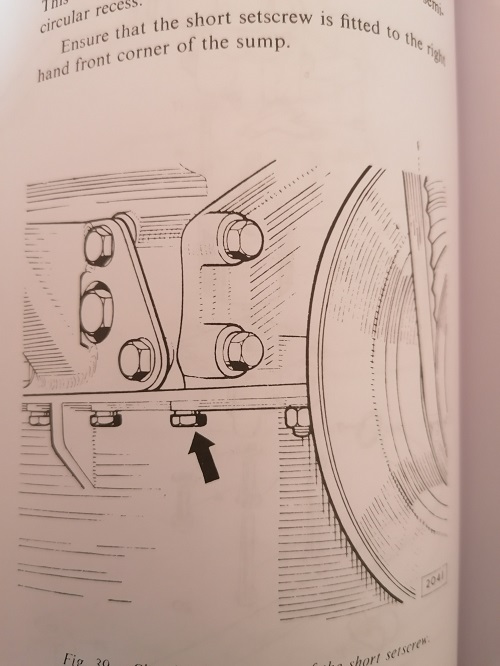

When reassembling, be careful :
* by putting the oil sump back in place, at the rear bearing seal, because it is possible that by touching the crankshaft, it moves and is no longer correctly placed in its housing.
* it is specified in the technical manual that the bolt at the front right corner of the engine is a little shorter than the others because it is just under the thread of a bolt of the "front timing cover".
