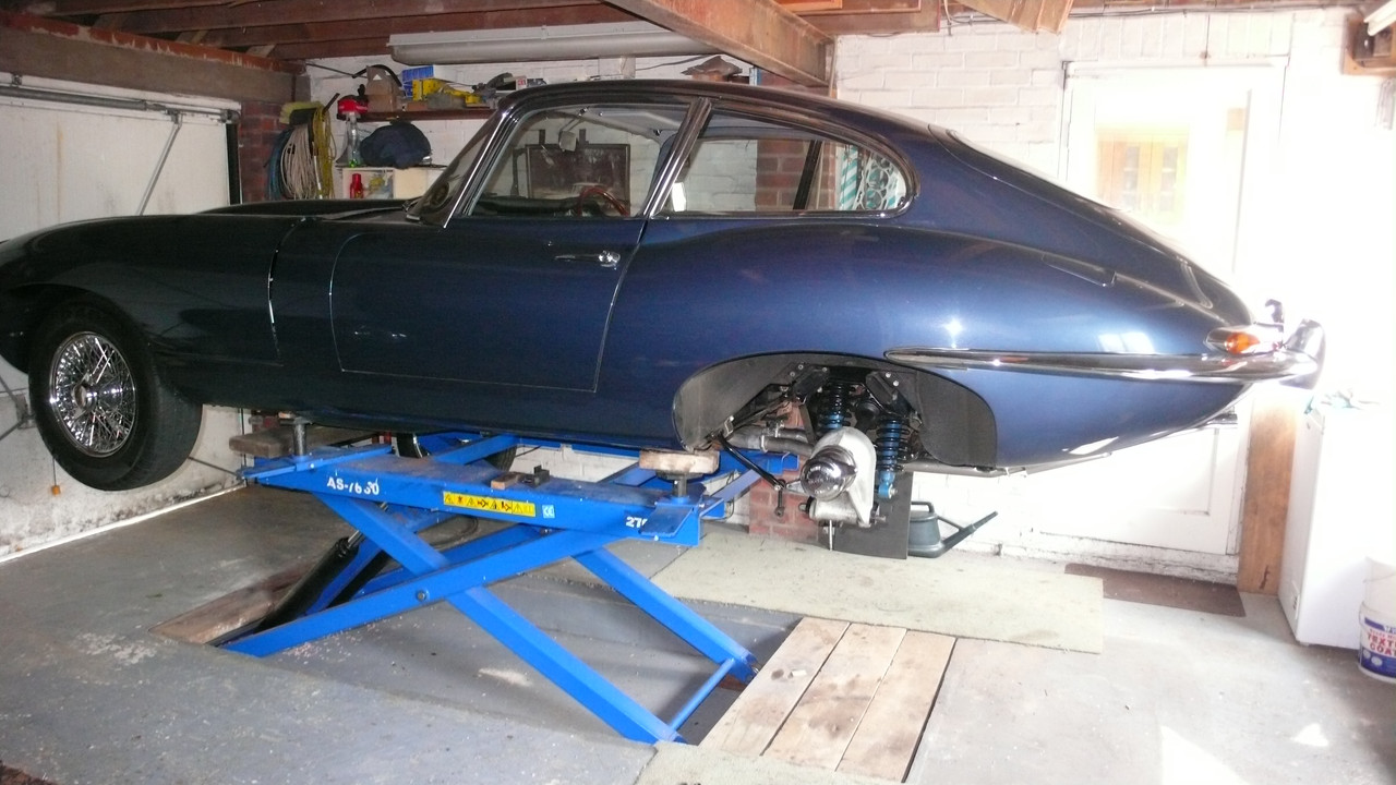

Bill,
I bought a hydraulic scissor lift about 5 years ago from SJR Garage Equipment Ltd.
It works well, has all the safety gear, and costs £900 + Vat.
Importantly, it's narrow enough for an E type or TR.
You buy two scaffold planks, and driver the car on those, over the lift.
Alternatively you can recess in the floor.
I had thought of buying a single post lift or a four post at the time, but they are pretty large and uncompromising.
You can also move this lift around the garage - albeit not regularly - it's extremely heavy.
I can send you some pictures if you want.
Nick

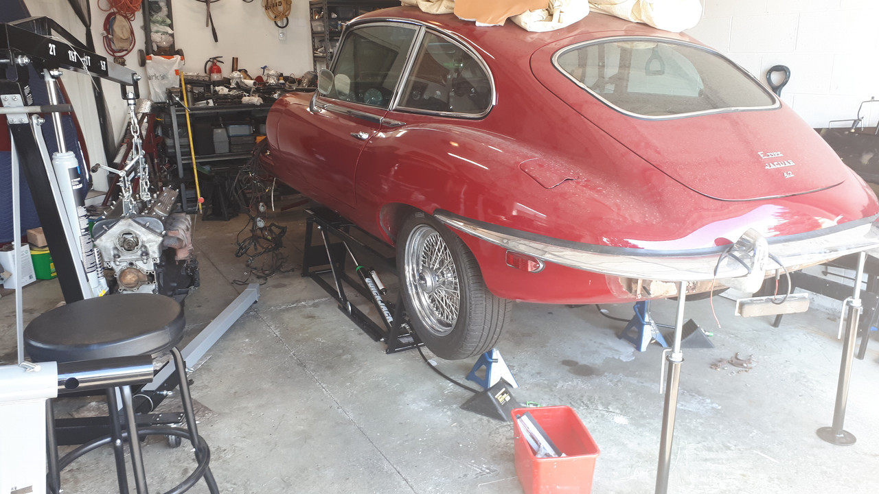

Quick jack on a 67 OTS, allows full access to underside front to back but only lifts about 22". Did my ful mechanical rebuild with it.
