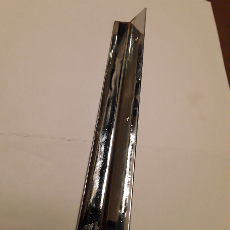

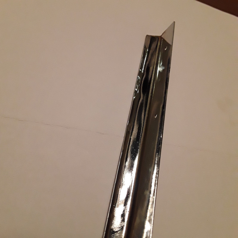

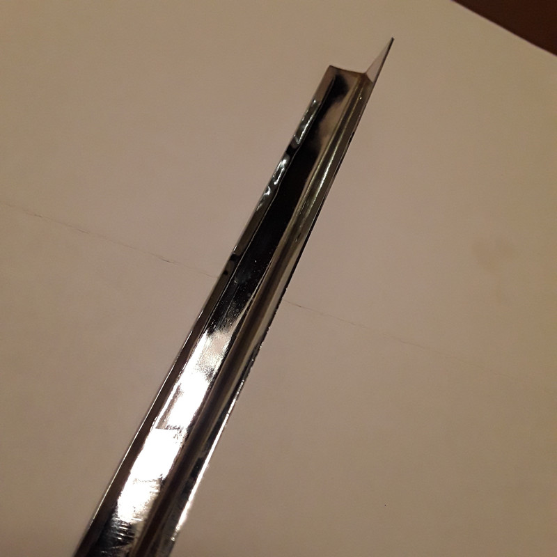

I recently purchased 2 more OTS hood cantrail chromes from SNG Barratts to replace the ones I bought a while ago from them that did not fit, however they are all rippled and deformed along the outer seen edge. I specifically asked for them to examine the stock and send me the best 2 that they had. The good news for everyone is that the final checking before dispatch is apparently standard practice now.
Also of interest is that these are now re branded as "premium" reproduction parts as opposed to "aftermarket" parts. I've noticed this on a few items recently on the SNG Barratt website so something must be going on in the background quality wise. Keep up the good work chaps.
Given that these are the best I'm going to get and I'll just have to work with them, has anyone got advice or suggestions how I can straighten out the ripples and defects without damaging the chrome?
Looking at the back of them it appears from the witness marks that it is a problem with the tooling or perhaps operator error. Unlike the headlamp trims in another post where it was difficult to tell which part of the manufacturing or chroming process had failed, it is clear with the cantrail chromes it is prior to chroming. Knowing this, it's a little frustrating these defects weren't picked up prior to chroming.
Anyway help with straightening them would be much appreciated as the alternative is to get them stripped and get the chromers to rectify them. I don't have a problem with that, it's the 8 weeks I lose waiting for them.
Thanks in advance and pics below.....

Afraid the simple answer is you cant. Any more than an extremely minor 're shape and the plating will almost certainly crack and possibly start peeling. IMO you will have to bite the bullet and have them stripped. Then fettle them so they are ripple free and fit your car...then off to chromers for replating...Cu then Ni then Cr

I have had some success in the past using a piece of shaped wooden dowel to massage out the dents in a similar way to paintless dent removal.
I have protected the other side with masking tape while supporting it against a 'dolly'

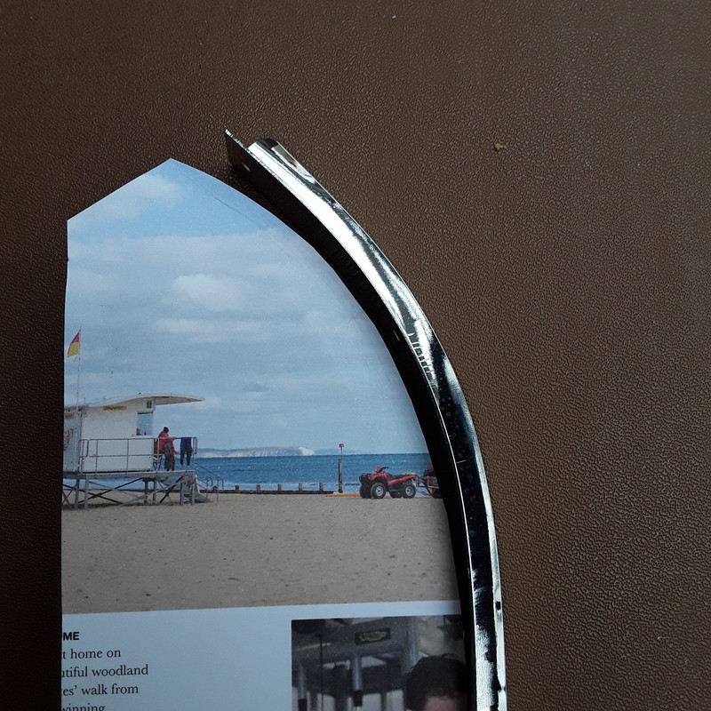

So distracted by the ripples and defects I hadn't even bothered to offer them up to the hood to check they were the right shape. Alas they are not even the correct radius compared to an original unmolested hood frame! :lol:
The cardboard shows the hood radius.
I was going to continue to moan about poor quality parts but quickly decided that wouldn't achieve much and certainly wouldn't get me any nearer to putting the hood seals on. :lol:

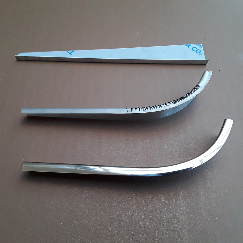

The solution......start again and make them yourself.

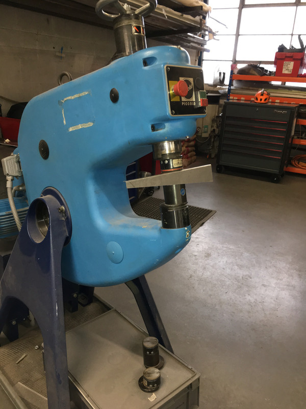

All you need is a spare Saturday afternoon, some 0.9mm stainless sheet , a guillotine, a hydraulic press brake , a large industrial shrinker stretcher and some basic workshop hand tools. :bigrin:
Once you've cropped and folded you part, on to the stretcher to get the correct radius. Hint to any prospective manufacturer this can be checked against a template. Several times if necessary. :wink:

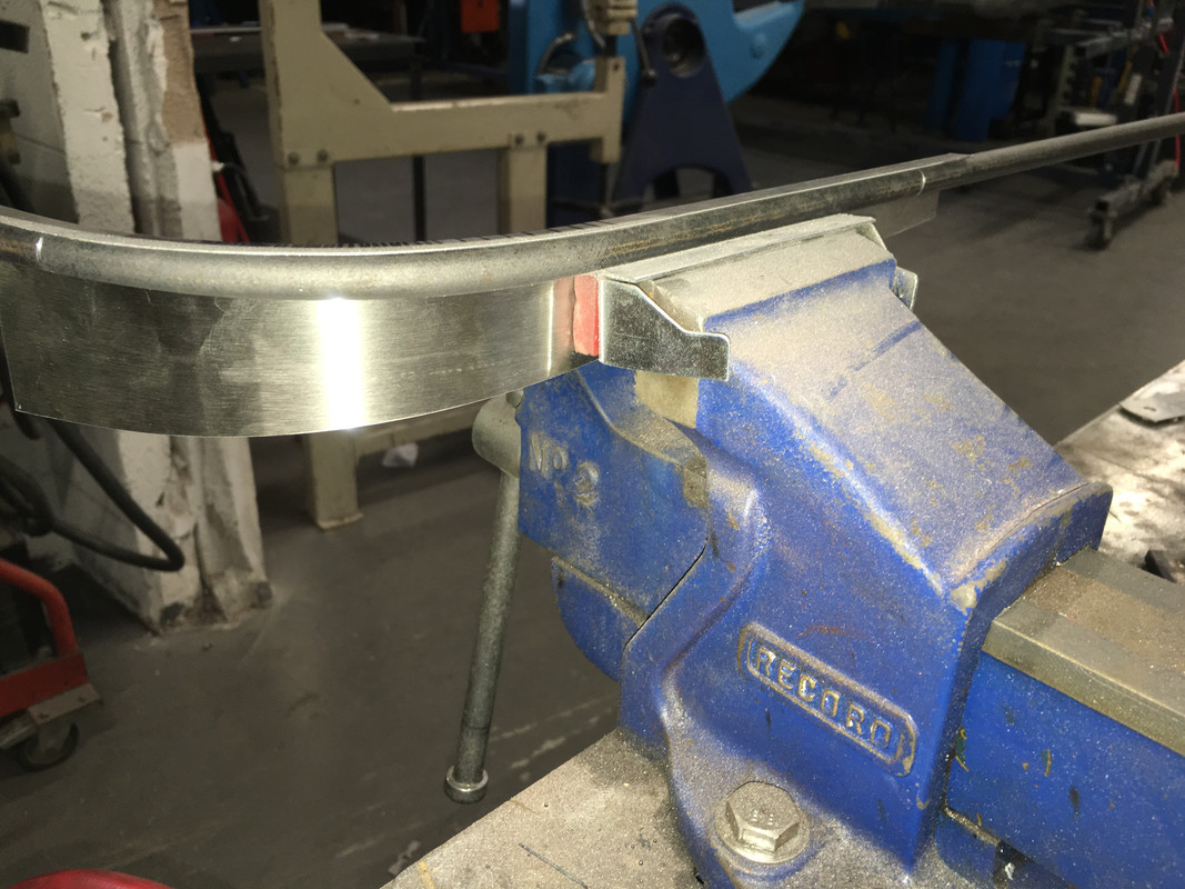

Then over to a piece of round bar bent to the correct radius to gently form the radius on the outer face. The tip here, again for any prospective manufacturer, is that you are aiming for a nice smooth straight edge rather than a rippled, mangled, uneven, tool/ hammer rashed mess.
Below show some of the stages, with the bottom being sanded and polished. They still need cutting down to the correct length and polishing again.
Thanks and apologies to the couple of forum members who did have to listen to me have a good old moan. :lol:

Simon, yes, all those high end workshop tools and equipment are in all of our garages just for such a task :roll:
I’m glad to hear you’ve got it sorted, how many orders have you taken? :bigrin:
