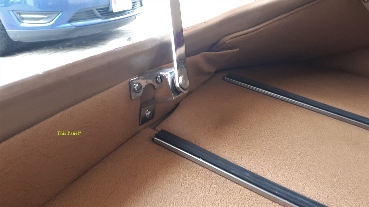

Hi, series 1 2+2. I believe that there is supposed to be a piece of aluminium that goes along the back of the boot area. I can see it in the BAS catalogue but not in the Jaguar parts list ?

If you mean the panel that is trimmed with vinyl right under the rear hatch opening it's in the Series 1 2+2 parts book. Plate 52, Item 6. BD.29245 Trim Panel Assembly, Below Back Door Aperture that is held on with 4 clips (BD.11309). The Series 2 FHC and 2+2 show the same part number for the trim panel and clips but the Series 1 FHC shows part number BD.20167 and it is held with 8 pop rivets (BD.1814/6).

Thanks Rick, yes I can see it now on plate 52. Will make one to fit.
