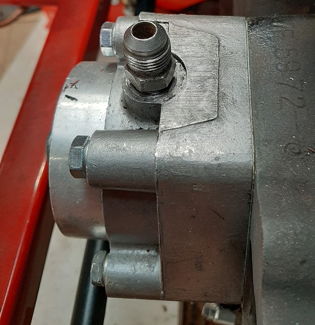

phoenix
Posts: 409
Location: Blackpool
#9 Re: S 1 4.2 oil filter blanking plug
Post by phoenix » Sun Feb 07, 2021 3:16 pm
This is my filter head .
20210205_103419 (3) resize.jpg (204.45 KiB) Viewed 3845 times
S1 4.2 RHD Bryan
Posts: 9124
#10 Re: S 1 4.2 oil filter blanking plug
Post by mgcjag » Sun Feb 07, 2021 3:42 pm
Filter head with spin on conversion...the hole in the top would usually have the electric sender unit.....but you could connect you wet guage ....looks like the compression fitting was used for a wet guage
