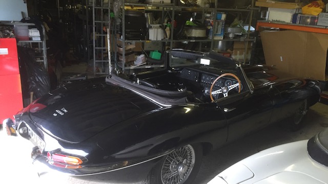

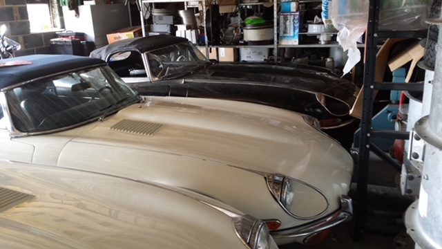

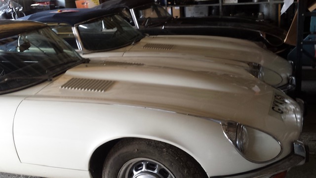

Thought I would add pictures of the other cars. My father was more into the E Types. We collected many cars over the years. When he passed 5 years ago I did bring myself to sell a lot of the cars as they were not being used and although in dry storage the condition does go downhill. We had a couple of early 2+2 cars that I sold but decided to keep the 3 roadsters pictured above plus now I also have the 64 FHC
The V12 roadster in the pic is one of the very last registered in 1975 on a N plate. It is a 1 owner 29000 mile car
However when new it was Pink and the owner had it resprayed white when not even a year old. It was re sprayed by the dealer that supplied the car new ?
Ive also got a factory manual 1977 XJS that getting rare these days
