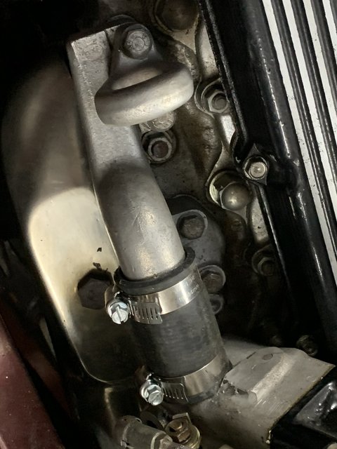

Early UK spec 1971 cars don’t have the thermostatic element to the vacuum retard system, we established this some time last year, a search of the forum might find the information, if not it can be proved by the parts manual. I remember it being a little convoluted in there, but basically, if you don’t have a temperature sensor on the R/H rear water pipe casting, adjacent to the R/H rear carb, then you don’t have the thermostatic controlled vacuum.
This is the pre thermostatic design of casting:
The thermostatic sensor is fitted to a later version of this casting.

My RH aft water pipe rail is identical to the one in Simons picture, so I don’t have the thermostatic vacum valve. My car is a relatively early -71 us, auto. But the engine is from a 74-78 xj12 injection - as far as I can tell by eng no. Don’t know type of water rail on xj12, but could be a mixmatch of parts anyway.
