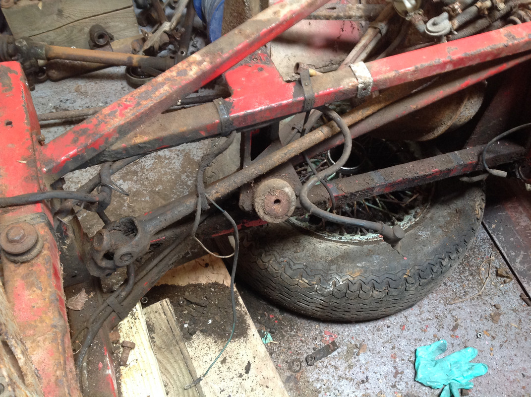

S1 4.2 where does the main battery cable route. Does it go over or under the engine. I would think over.
S1 4.2 RHD Bryan
Posts: 9225
#2 Re: Battery cable
Post by mgcjag » Thu Mar 04, 2021 8:00 pm
The starter cable comes off the terminal at the left side of the car, runs along the underside of the outer/upper frame rail, continues under the upper member of the picture frame, and then continues along the inner/upper right-hand rail on its way to the starter.

This was posted before:...
