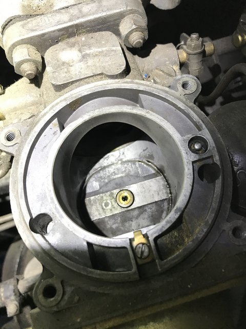

- measured the plastic landing inserts in the carb pistons. They are only 0.25 mm high, so this is the height of the slot the air must get through. I could not yet find a value for the slot, but iirc it was 0.25-0.35“ - which is a lot more then .25mm. Maybe the inserts are too flat ? Can they be renewed ? Why did they not use a worm screw....hm, maybe thats a repair method which would give an adjusteable piston landing.

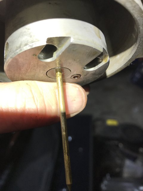

Hi Carsten...ok so you have the wrong needles but it your photo above the needle is not positioned correctly. ....see the instructions i posted above showing the needle position in the piston.....Steve

UI are slightly richer than UM but not as rich as UE or UO which are commonly used richer needles ( although i advise against them unless your engine is radically modified ) . They certainly should not prevent you getting a cold start. However, it seems from what Stuart has said ( I really cannot see myself on your photo what has happened) that you have not positioned them correctly - I always set mine with the shoulder flush with the base of the piston - and if you have put them significantly lower than this then you will have very weak mixture, which could well explain your non-start
PS I am not really sure what your reference to plastic inserts is about. Where and what are these ?
