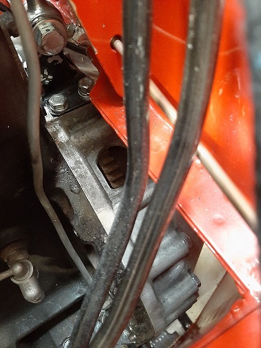

Post by phoenix » Wed Mar 24, 2021 4:52 pm
This is the photo of bung hole . It is sort of D shaped .
S1 4.2 RHD Bryan

#8 Re: S1 4.2 gearbox bellhousing bung
Post by mgcjag » Wed Mar 24, 2021 4:58 pm
As mentioned in other posts there is no bung to fit in there.........Steve

#11 Re: S1 4.2 gearbox bellhousing bung
Post by paulsco » Wed Mar 24, 2021 6:01 pm
Bryan,
That is not an original Jaguar access hole, or at least not E-Type; I expect someone has done a DIY job.
Edit: It has been pointed out to me that this hole does appear on 3.8's and early 4.2's, so sorry for the miss-information.

#12 Re: S1 4.2 gearbox bellhousing bung
Post by tim wood » Wed Mar 24, 2021 6:21 pm
Looking at the photo the bolt fixing the stabiliser seems to be a wire lock version which I don’t believe is correct.
Also what is that pipe running through the stabiliser fixing bracket?

#13 Re: S1 4.2 gearbox bellhousing bung
Post by steve3.8 » Thu Mar 25, 2021 1:46 pm
tim wood wrote: ↑
Bryan previously asked about the brake pipe routing , someone kindly posted photos showing--so maybe it is just that instead of doing --master cylinder- right hand frame-picture frame-joint-left hand frame to servo he has decided to take a short cut across the bulkhead. I would say not ideal as fitted as it could rub through causing total loss of brakes on the single line 4.2 and a potential fire -there are also carbs, throttle linkages ,rocking engine ,heat ,etc going the bulkhead route .

#14 Re: S1 4.2 gearbox bellhousing bung
Post by phoenix » Sat Mar 27, 2021 8:44 pm
Rerouted thanks :yellow:

#15 Re: S1 4.2 gearbox bellhousing bung
Post by PeterCrespin » Fri Apr 02, 2021 12:09 pm
Now fill the holes?
May I suggest two not at all D shaped rubber bungs - aka blanking grommets, pro-tem?
