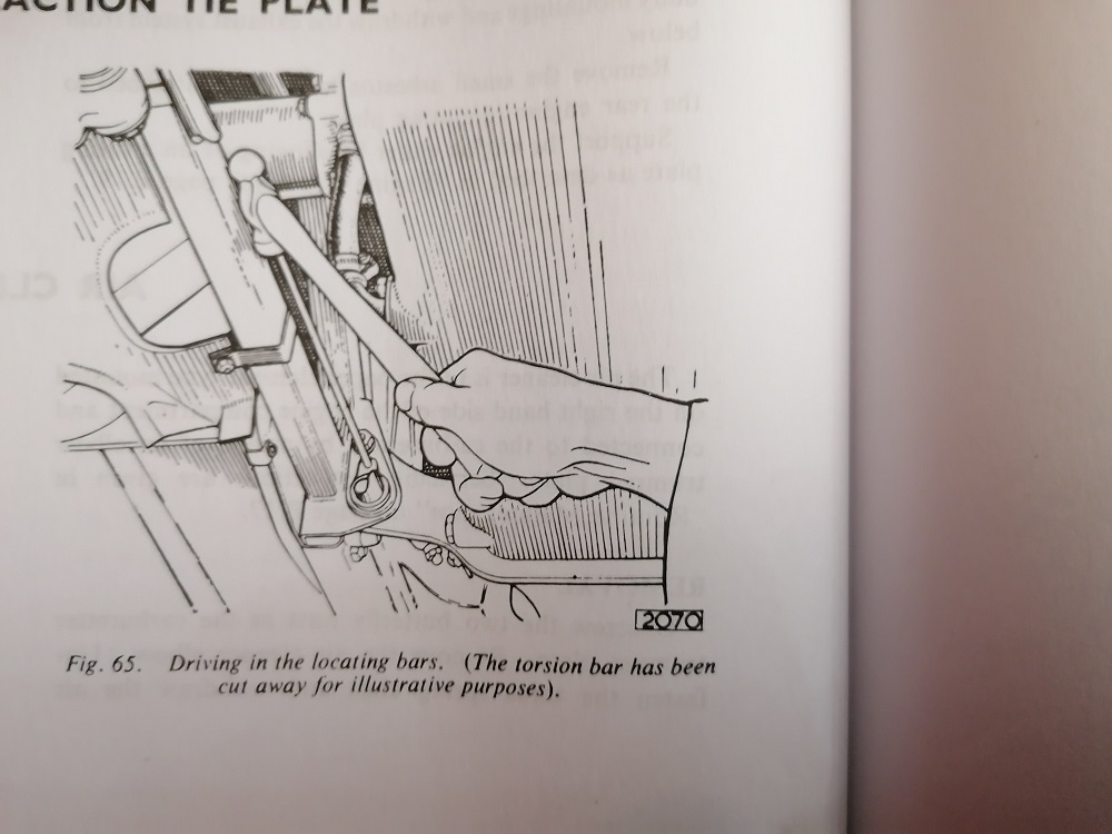

Hi Andrew...yes page B67..Reaction plate removal and diagram fig 67.....Steve

Hello,
To dismantle the "reaction plate", I found an interesting video on youtube:
But in the end, I followed the procedure in the B67 manual, which is a bit different, but requires making 2 bars : 10 inch length, 3/8 diameter, rounded end.
But, after putting these 2 bars in the bottom holes of the reaction plate, I also found that there was still a lot of pressure in the torsion bars. To relieve the pressure I separated the 2 upper wishbones from the stub axle carriers. In my case this was sufficient, but perhaps for you, it will be necessary for you to dismantle one of the ends of the 2 shock absorbers.
The only difficulty encountered is getting the flat reaction out of the car. I had to use a tool to pry the gearbox housing, being very careful not to damage it. To put the reaction flat, it was a little easier using a hammer and a piece of wood to avoid damaging it.
Then, to put it back in place, you have to be able to replace the top bolts, acting on the 2 bars so that the top holes are aligned. Normally, the bolts should retract by hand without tapping with a hammer. Finally, by tightening the top nuts, the flat reaction will return to its initial position and you can then remove the 2 bars and put the remaining 4 bolts.
Allow about 45 minutes to dismantle the reaction plate and 45 minutes to put it back.
Good DIY.
