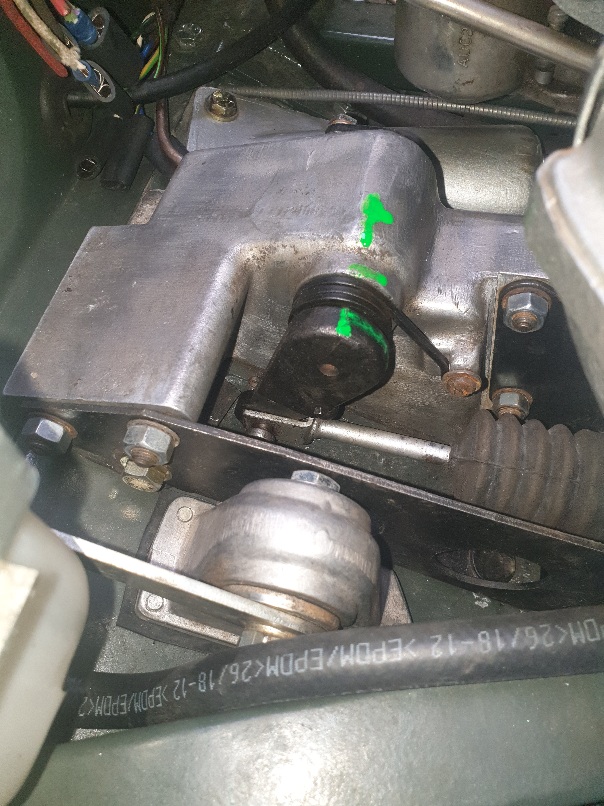

There are 3 iterations of pedal boxes.
3.8 has Kelsey Hayes system.
Early 4.2 (first year) had a transitional box similar in design to the KH; this is shown above.
After that it changed to the loaf shaped unit.
If you send us some pictures we might be able to help you.
