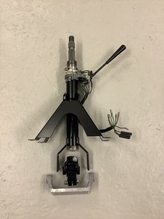

Hi Neal, I have had problems attaching photos but think I’ve got that sorted, as you’ll see I’ve bought series 1 / 1.5 parts but with the indicator/horn push attached the column spline doesn’t protrude through the tube enough to locate the UJ

This column measures 29cm long. I’ve seen posts with longer shafts. Does anyone know if this is correct or do I need a longer shaft. What length are the new Barrett shafts. They haven’t got one in stock to measure but think 30cm or there abouts

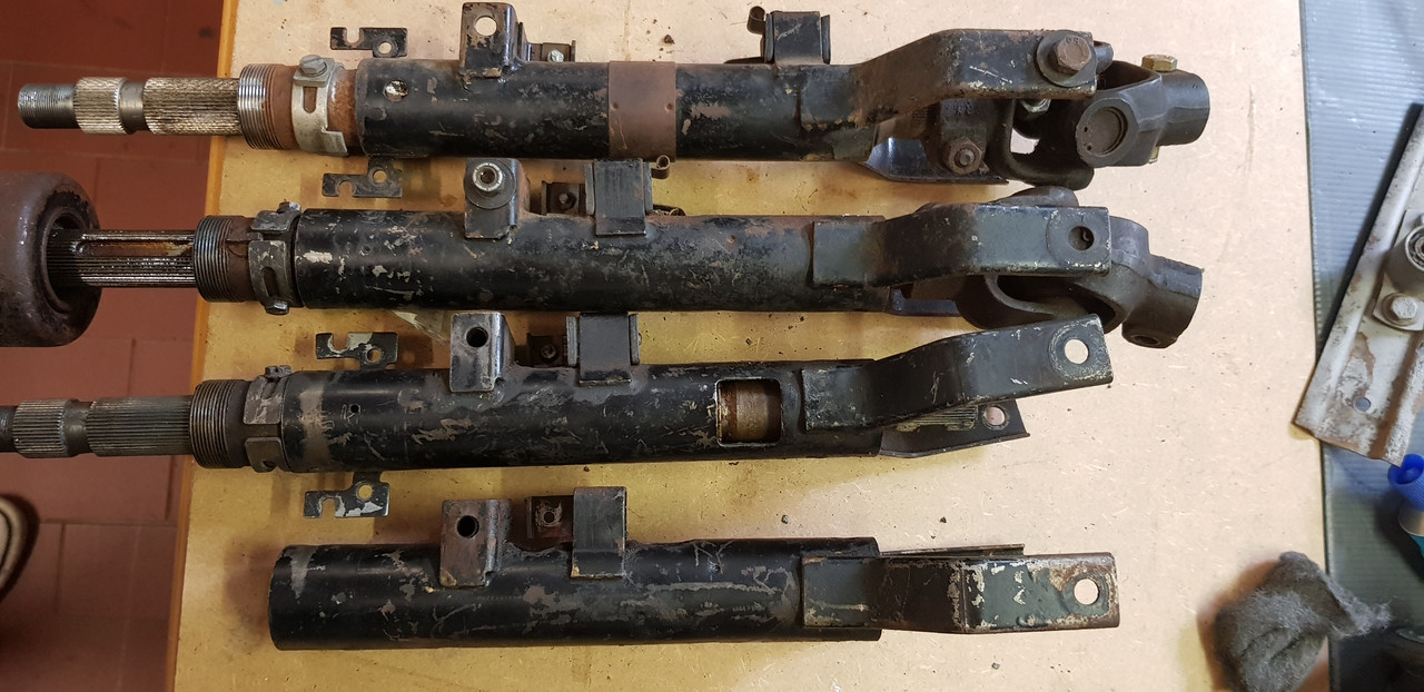

#9 Re: Series1.5 steering column conversion LHD to RHD
Wrong outer tube is the problem here. The S1 4.2 had a slightly different arrangement for the indicator switch .There are some photos on here somewhere comparing two or three columns . The column shafts are all the same length - but the slip ring mounting can be in two different places.
The photo is someone elses not mine but shows the variations. Note the different tops to the tubes on numbers 1 and 3 (top to bottom)
Barrie
Barrie

Thanks for the post. The top tube looks to be shorter at the top end and would work without the indicator locating lugs but this tube doesn’t seem to be available.

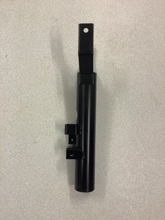

The attached photos show Barratts version of the series 1 / 1.5 tube and the inside of my indicator with the white plastic section which sits past the end of the tube

Well which way you go with this is up to you. To recap you have a 3.8/early 4.2 inner column and outer tube plus a late s1.5/s2 switch. The late s1 4.2 columns had mounting flags brazed to the outer tube (rather than a bolt on bracket) this used the s1 indicator switch. The later switch had a plastic ring actuator and the outer tube was reduced in length to accommodate this. The switch you have is a late s1.5/s2 switch for the collapsible column which had no provision for a horn rod - so they moved the horn to the stalk . All s1.5 RHD used the rigid column (at least as far as I can tell currently) and a correct one is at the top in my previous photograph. So your options are -
a. change the outer tube to a later type if you can find one but you may find the slip ring position has moved in which case you will need the inner column to match.
b. change the switch to a 3.8/early 4.2 type. This will allow the inner column to sit lower down and protrude far enough for you to connect the lower column.
Barratt will not have anything for RHD s1.5 (with collapsible column) as such an animal never existed as aforesaid.
Let us know how you get on
regards Barrie

Sorry I’m late responding to all the update posts. I’ll try to cover them in this reply. Firstly dealing with Robsan and tinworms posts re LHD cars:- Series 1.5 LHD cars had the collapsible upper and lower columns to comply with Federal requirements. They also had the horn push incorporated in the indicator stalk. RHD cars did not have these features but had the same arrangement as the series 1 4.2 cars. It’s not possible to just switch the LHD steering column over to RHD. The lower attachment point on the RHD side of the car is solely for the RHD tube and bracket, the top bracket is also different in that on RHD cars it incorporates rake adjustment. The LHD upper assembly with the collapsible tube attaches to the top bracket and underside of the dash in a different manner. The LHD lower column is shorter than the RHD column. Without the series1 lower bracket the top UJ fouls the underside of the dash. The conversion requires series 1 mounting brackets, outer tube, upper column, bearings, lower column and UJs. I believe it’s still possible to use the indicator with the horn but the problem I’ve found is that only one tube is listed for both series1 & 1.5 cars and when the switch is mounted the upper column does not protrude from the bottom of the tube sufficiently to mount the UJ.
Addressing this point Neal says the tube needed measures 198mm whereas the Barrat tube measures 220mm. The section above the top mounting point seems longer on the Barrat series 1 illustration than the series 1.5 illustration but the part number given is the same. It seems that the overhang of the switch at the top of the tube pushes the column too far back, leaving the column short at the bottom of the tube. Bearing in mind that all outer tubes except LHD cars have tubes with mounting points in the same dimensional relationship at present I think it is possible to shorten the top of the tube by around 16/20 mm which will allow the column to protrude at the bottom of the tube. There is still enough room to mount the indicator shroud and probably the adapted ignition mounting plate from the LHD car which doesn’t have the steering lock.
Tinworms photo of a collection of upper columns show the tube at the top of the photo which is shorter and may fit but we don’t know what car it’s from or if it’s available anywhere. Any comments on my idea to shorten the tube would be welcome.

The shorter column in the picture may be from a Mk2 saloon.
