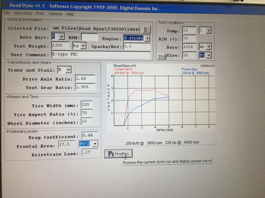

Where is this setting of higher number of pulses per rev ??
The Config menu only has these settings:
Also, what did you set for::
- Spark/rev setting
- Drag Coeff
- Frontal Area
- drive terrain loss
Tadek
