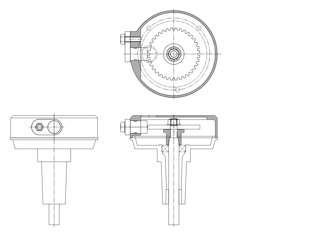

Here is pic of my sequential ignition CnP (coil near plug) arrangement, also distributor converted to 36-1 cam position sensor.

lowact wrote:
Fri May 14, 2021 1:09 pm
Looks great Colin !
The pictured coil looks quite heavy and the ALU-cooler on top let's me assume that the coil driver sits on top of the coil. Do you know the characteristics of the coil like AMPS, dwell time, and which spark plugs do you use ?
@Marek: That is why I think this could be a good upgrade and I was interesing in existing implementations although I did not plan to EFI upgrade my PRE-HE but only optimize ignition.
Thanks, Tom

lowact
Posts: 769
#15 Re: EDIS question
Post by lowact » Fri May 14, 2021 2:13 pm
Is not complete, work in progress, optimistically another 6 months ...
Here is the cam position sensor, Honeywell SNDH-H3P-G01, able to read 3 mm teeth at speed...
The coils are GM spec 19005218, 40kV, built-in drivers, they fit very tidily between the injectors.

Post by myJagV12 » Fri May 14, 2021 4:18 pm
Well mine is work not even started ;-)
Won't this hall effect sensor be too slow (12kHz) ?
I was thinking of something like MLX91209CA and plan to use two of them for redundancy and to read half teeth.
btw: like the color of your E - did you also paint it opalescent gun metal grey ?

Posts: 1759
#17 Re: EDIS question
Post by MarekH » Fri May 14, 2021 4:55 pm
If the car redlines at 7200rpm, that's 3600rpm for the distributor, which is 60revs per second, seeing 2160 teeth per second (36-1 wheel). That's less than 12kHz.
