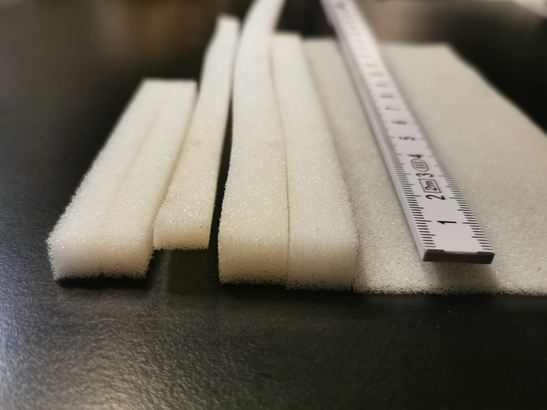

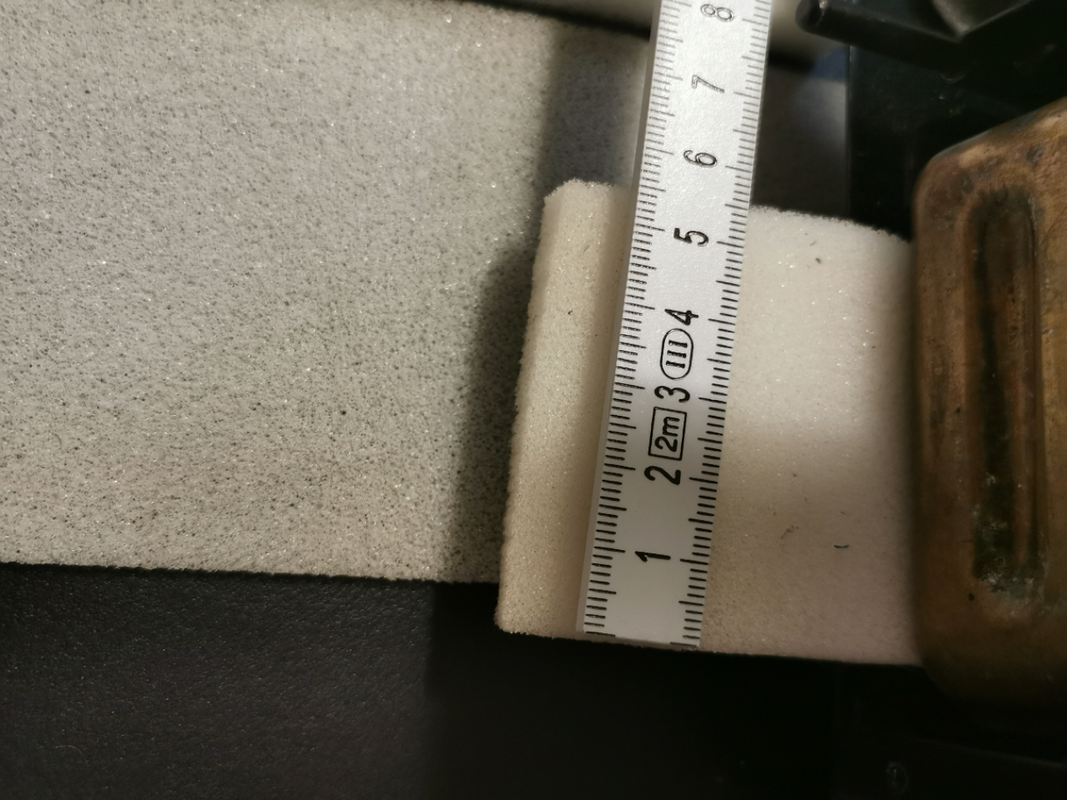

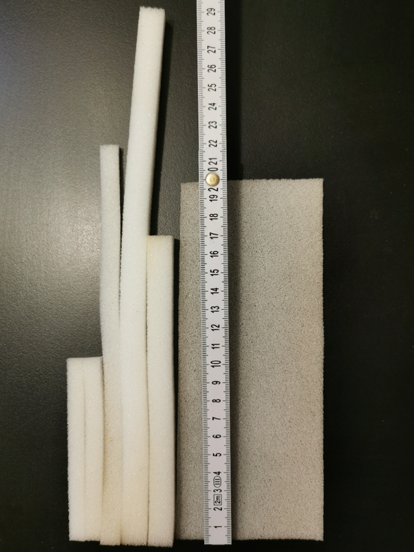

I'm currently assembling my heater box and wanted to share the heater seals as part of a kit.
The kit was quite expensive for what it is so maybe some of you requiring new seals wants to make these foam-parts by himself.
The kit contains 7 pieces as seen on the pictures.
Main piece to surround the heat exchanger size 60x6x1.2cm
Flap cover 20x8.5x0.3cm
Flap surrounding 30x1.4x1.4, 17.5x1.4x1.4, 10x1x1, 10x1x1, 22.5x1x0.6cm

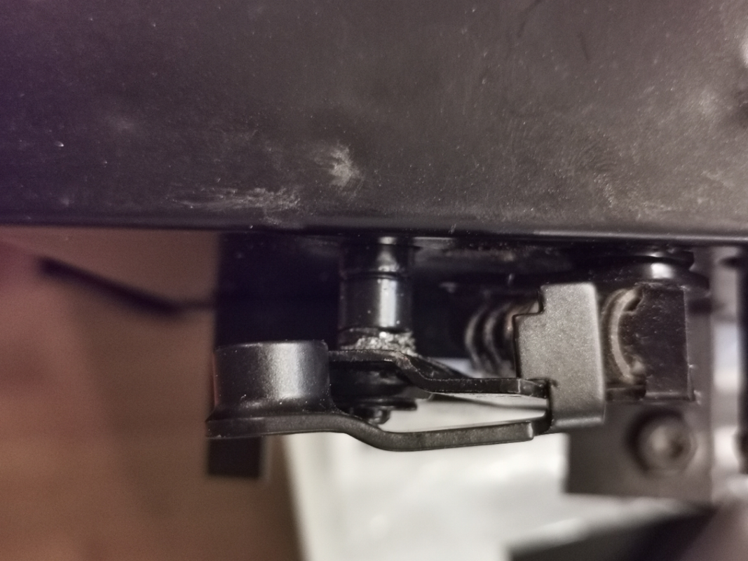

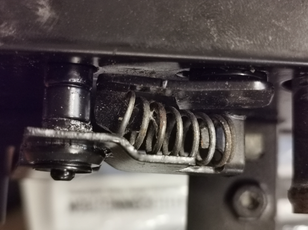

When assembling the aftermarket box I headed a problem with the flap mechanism.
The lever is different from the original one so the spring won't fit between preventing the flap to fully close. Seems they require a different spring but it was not included in the kit.
I powder-coated the original lever and will try this one instead. While the original box was rusty and rotten at least the mechanism worked ;-)
I will also provide this information to SNG.
see attached pictures !
BR, Tom
"Squeezed" spring blocking flap
The old part looks much wider and gives the spring enough space
