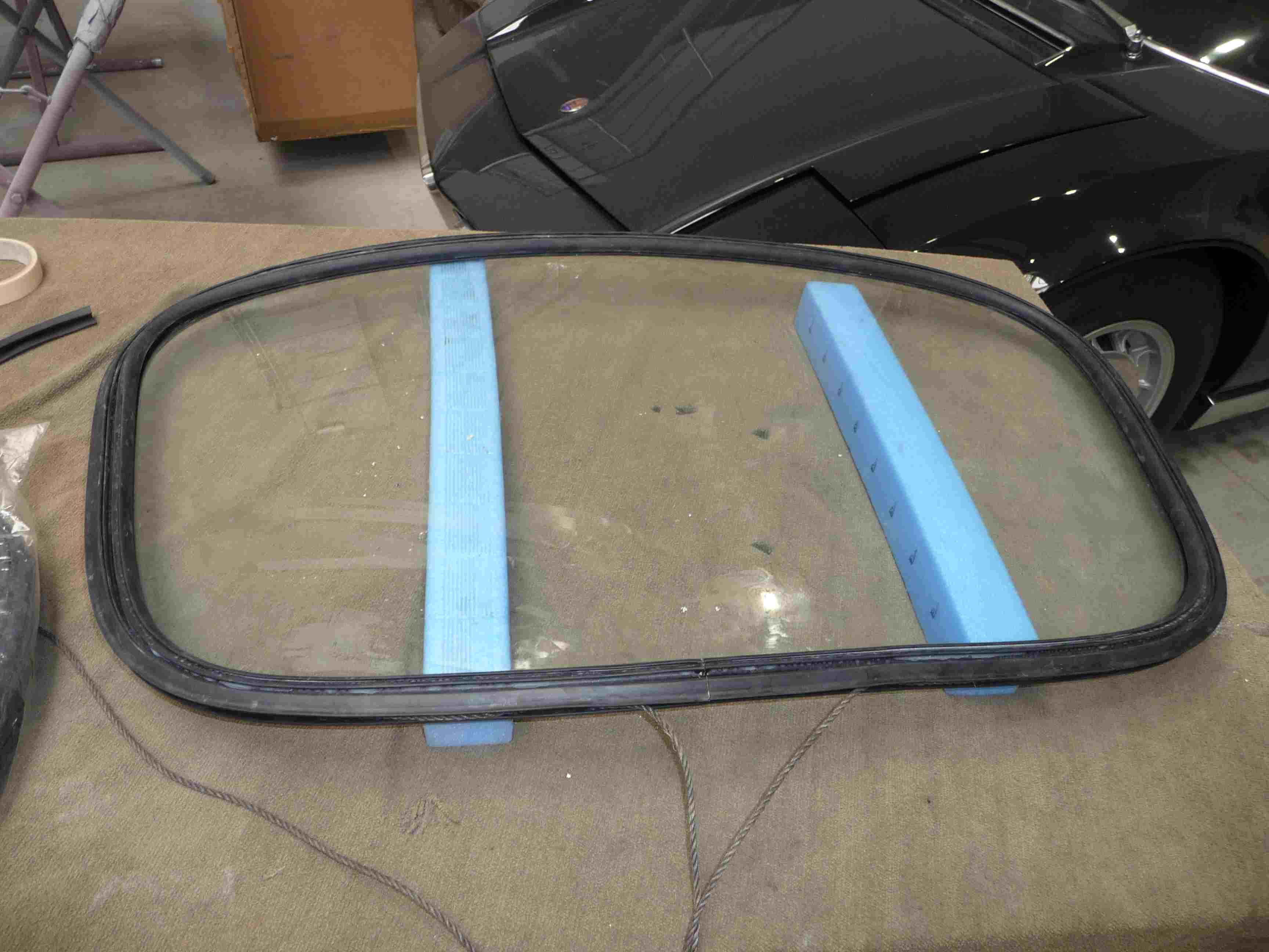

To my surprise, the restoring shop tells me that the rubbers to be fitted around the rear hatch window and the windscreen are too hard and could not be installed using the rope technic unless risking breaking the glass.
Is there any trick to install these rubbers safely, e.g. by pre-heating or else?
Which supplier for supple windscreen rubbers?

I had mine from baines as well. I fitted the rear hatch myself, I just cleaned of all the white powder from the rubber and left it on the radiator to get nice and warm, which made it more flexible. I didn’t fit the windscreen myself, I got Autoglass (they have a classic car department) to fit the original glass. I cleaned and heated up the rubber for them in the same way. From memory, they didn’t use the chord method.

I had the same problem with my FHC a few years ago. The problem was down to a NOS seal which had hardened with time. Bought a new seal from Baines and the rear window went in no problem.
Lesson I learnt was to only buy the seal when you are ready to install and get it from the actual manufacturer (COH Baines) then you can be sure you’ve got fresh rubber.

When looking at the seal in detail, its internal rouded part looks hard because it is rather thick, while the external part looks more flexible because it is grooved to host the chrome finisher.
He will therefore try installing the seal all around on the body first (without the glass) and then only, because of the more deformable external part, insert the glass from outside.
I hope it will work...

Finally there, using the method described above (inserting the glass inside the rubber only after that one already in the door frame)
