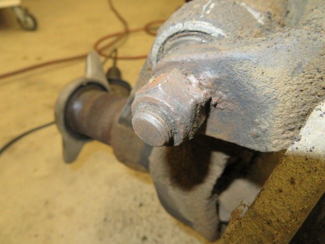

I started disassembly on the IRS and wondered if the lumps underneath the grease/dirt/oil on the fulcrum nuts was just grease…nope…PO decided he didn’t want those nuts coming loose…weld them up! Glad he was not much of a welder!

Car may have been used on a circuit ?

Post by mxke » Mon Jul 05, 2021 1:07 am
I don’t know if it was ever put on a circuit. But an interesting thought.

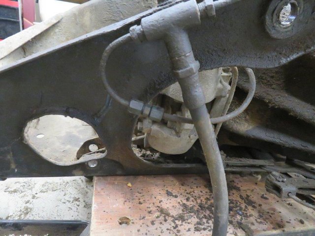

Post by mxke » Mon Jul 05, 2021 1:09 am
When the brake joints won’t come apart, it’s OK to use a plumbing fitting to join two pipes, right?

Post by mgcjag » Mon Jul 05, 2021 6:25 am
If its a standard compression plumbing fitting then no.....but a brake union with flared ends on the tube is a recognised connection in brakes.....Steve

#6 Re: IRS chuckle
Post by mxke » Mon Jul 05, 2021 2:52 pm
Oh it’s a standard plumbing connection!
The PO did some fine work!

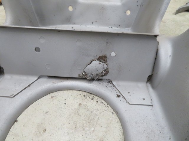

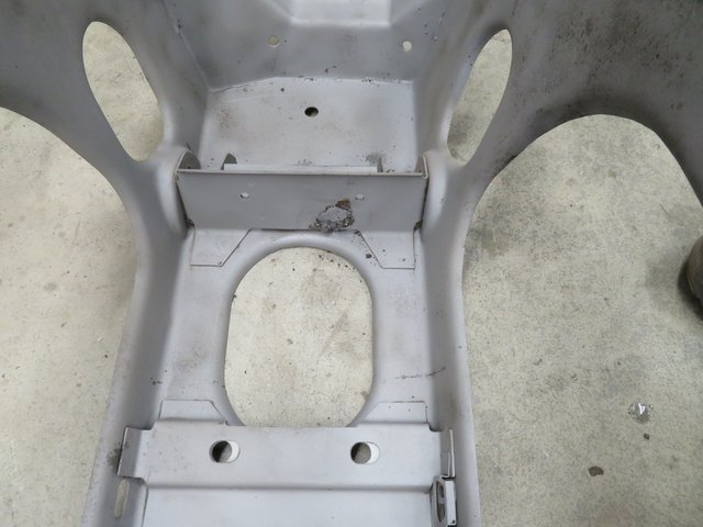

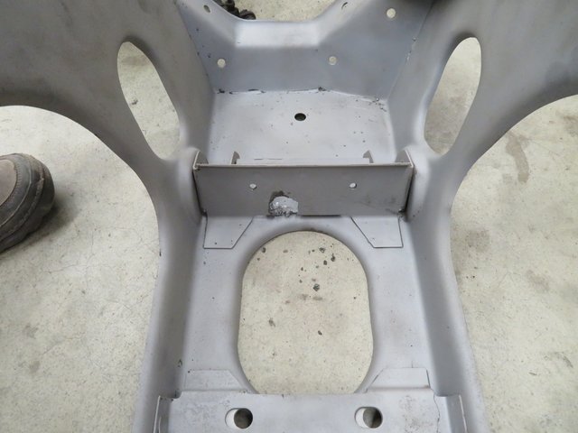

Post by mxke » Sat Jul 10, 2021 12:33 am

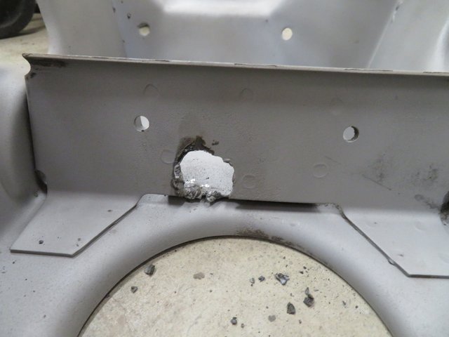

After getting through the grease oil and dirt to a clean cage, I find these two holes burnt through the cage. Curious if this is PO modification to get at something on the rear brakes?
