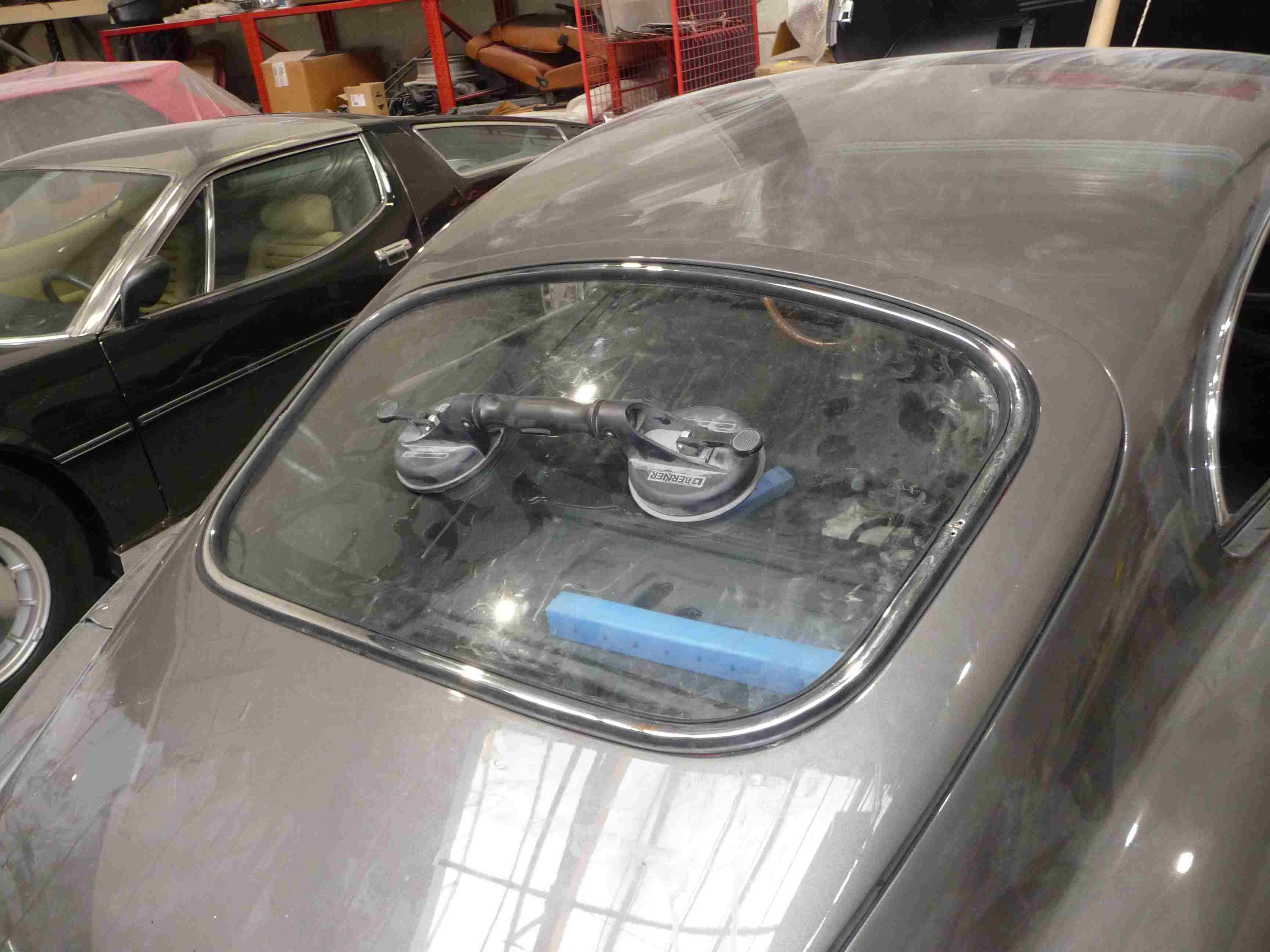

Finally there, using the method described above (inserting the glass inside the rubber only after that one already in the door frame)
