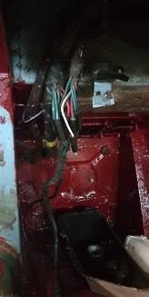

Series 1 2+2.
Hi does anyone have a photo of the trim that covers the wiring on the LHS bulkhead fitted please?
Part number BD 29152.
The parts book says its fitted with 3 bifurcated rivets but there is no way my cover is going to line up with any holes in the bulkhead ( I can only find 2 ).

Hi, anyone have photos of how this wiring is held in place ?

I never got mine to line up with any of the holes.
Simply drilled new ones and secured it with trim screws with cups. Secured to the left hand panel. The cover was trimmed to match the footwell trim and the screws were not visible once the footwell panel was in place.
