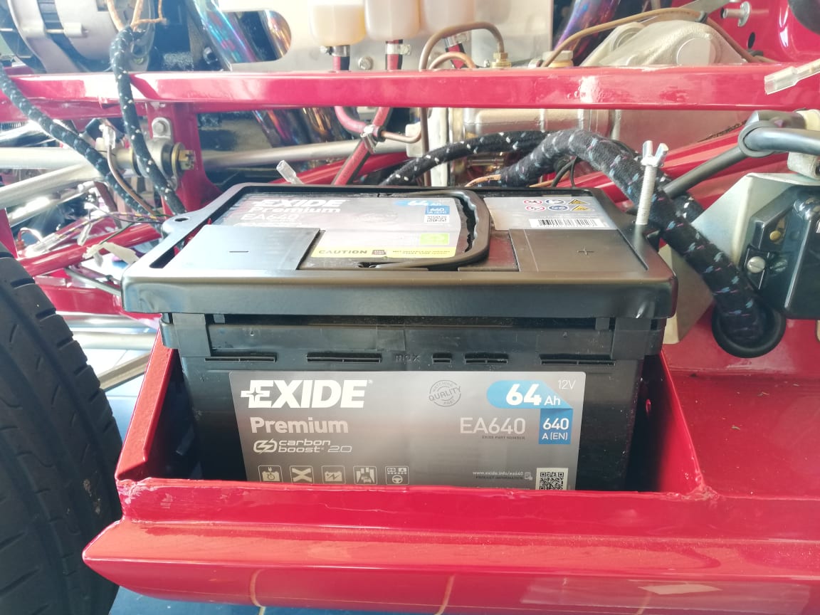

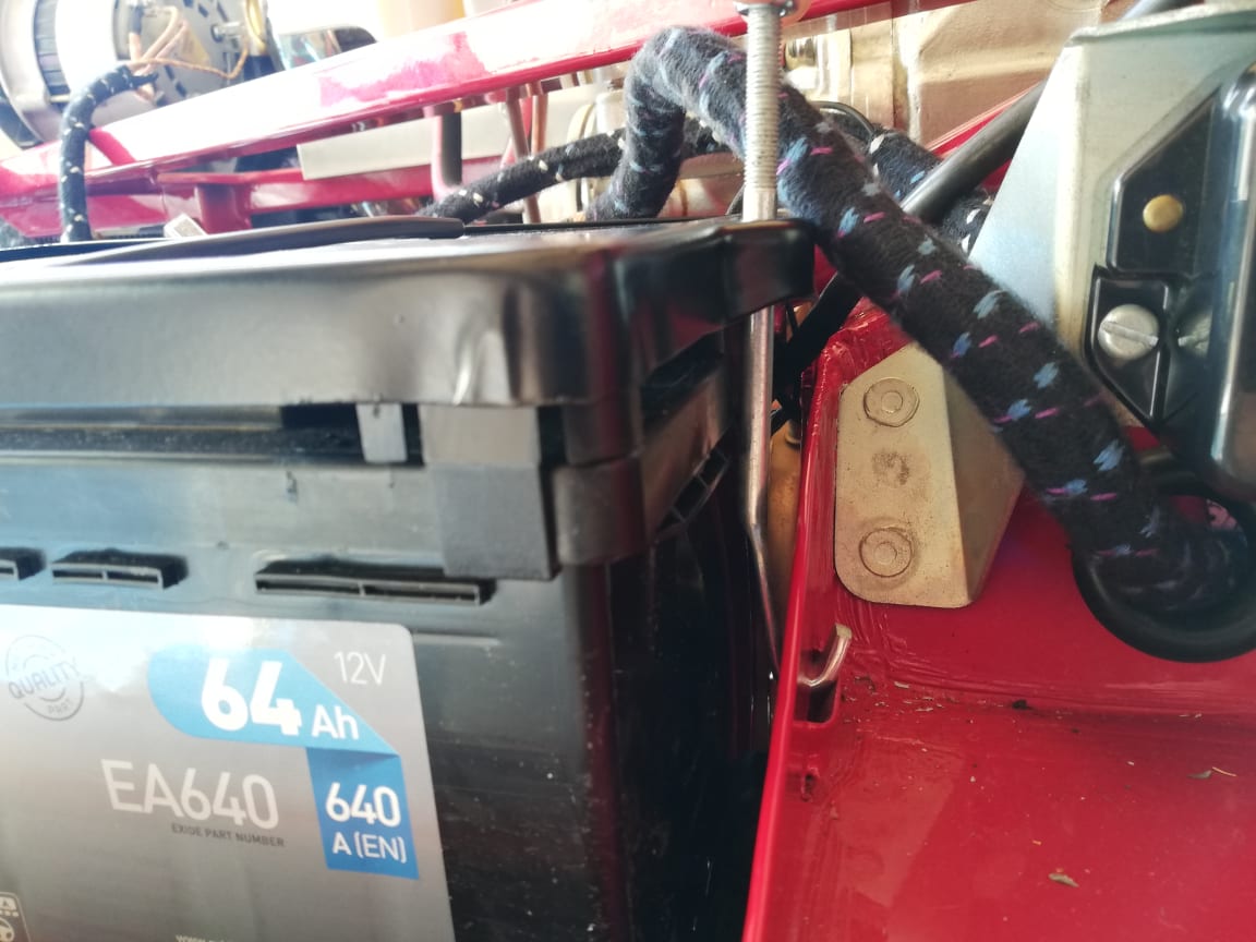

When I got my E-type it was in half, thus I have no pictures of how this should be.

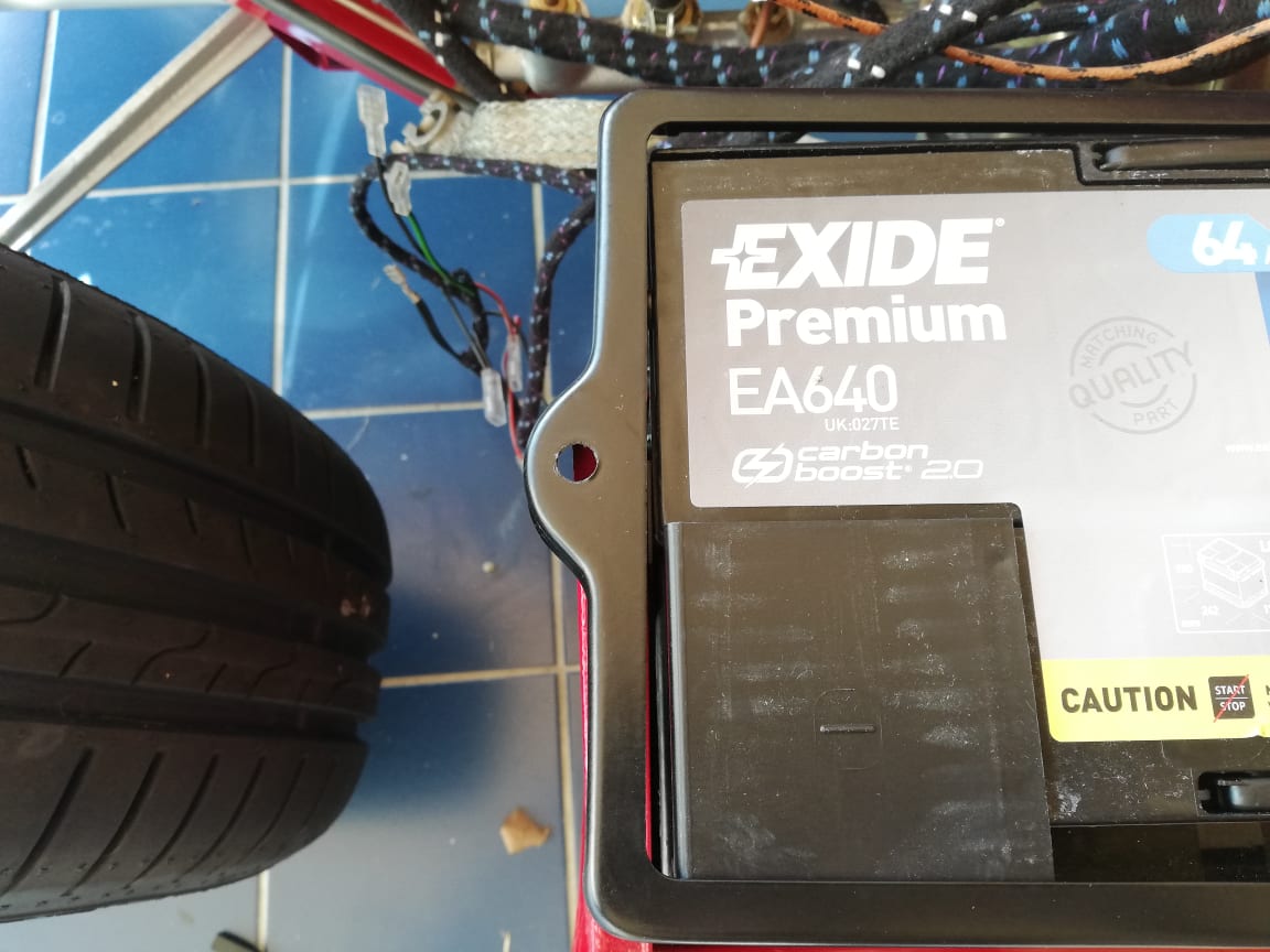

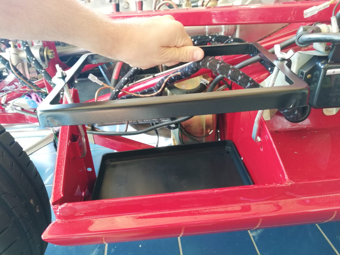

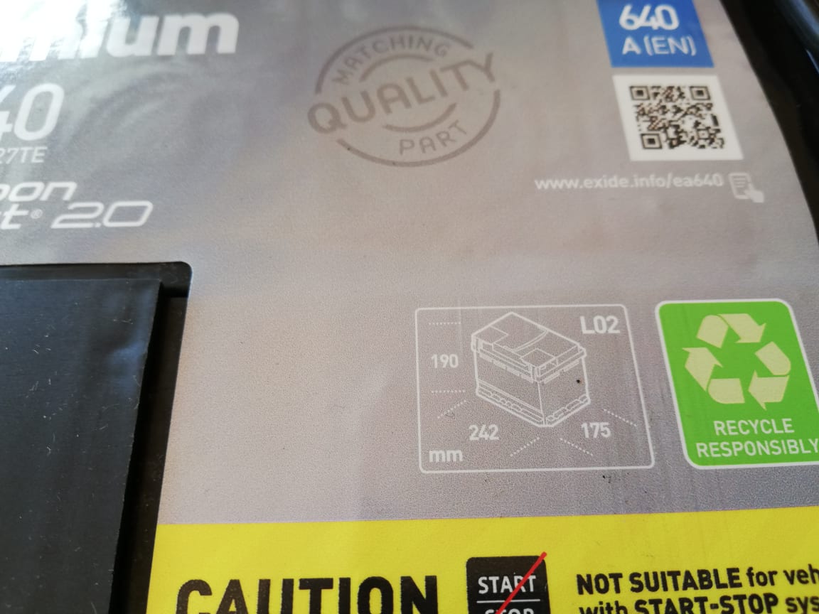

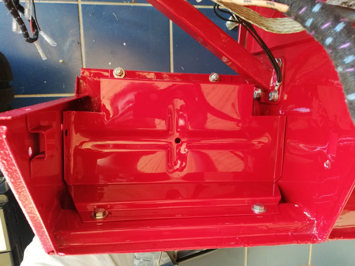

Anyway the problem is that the battery and battery clamp is to long...
At the moment the battery is not original but has very close original dimensions with only the width 10mm wider.
I suspect that when the sill was replaced it must have been a little shorter than original since the battery clamp will stick outside the end of the sill. My plan is to shorten the batteryclamp with 20mm and attach the battery hooks in the walls... Not sure if thats original or not.
Do anyone have some pictures to share on their original battery setup?
Is there anything wrong with my plan that anyone knows about that will create future problems for me?
See the attached images for better understanding :)
Thanks for your time :)

Your main problem, as you have already highlighted, is the clamp protruding out past the sill into the wheel arch.
Does the bonnet close without hitting the clamp? If not then you may have to abandon it altogether and go for a non-original clamping arrangement, many members have already done this.
The second issue of the clamps being too long can be solved by using spacers between the clamp and the wing nut. I've had to do this on the rear one not because it's too long but because the wing nut fouls the web beside it.
In general the battery arrangement is not one of the E-Type's better thought out areas. Even with everything as it should be space is very tight. Even with the correct size battery fitting it is a real faff.

I have exactly the same problem with my 3.8 FHC. I have concluded that the battery clamp is just too long and, like Thim, have decided to chop 20mm or so out of it. I just need to find someone I can trust to do it.
I also seem to have a problem with the clamping rod fouling on the regulator bracket.
They modern battery terminals I am using are also in danger of shorting on the battery clamp and need to be fitted very carefully.

You're not alone - it was the same problem on mine as well.
I had to cut a section out of the top clamp and get it re-welded.
If you've not fitted it already, check the air-filter support bracket. Again, it needed shortening on mine.
I never worked out which bit of the car caused the problem, and it all fits now so I'm not worrying about it.

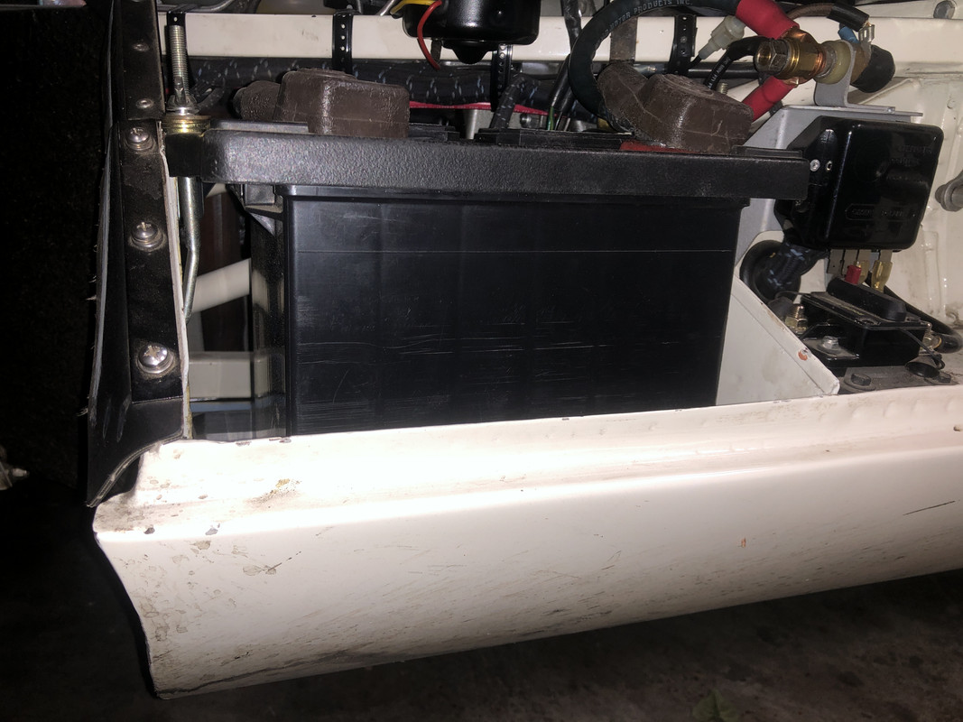

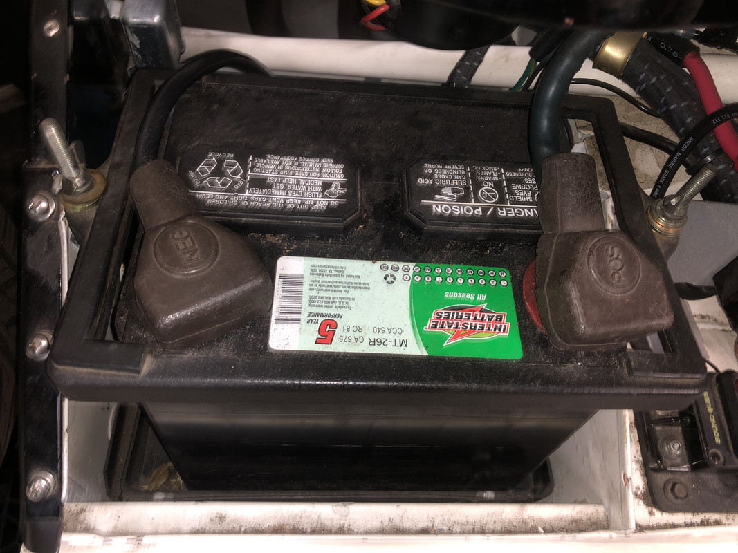

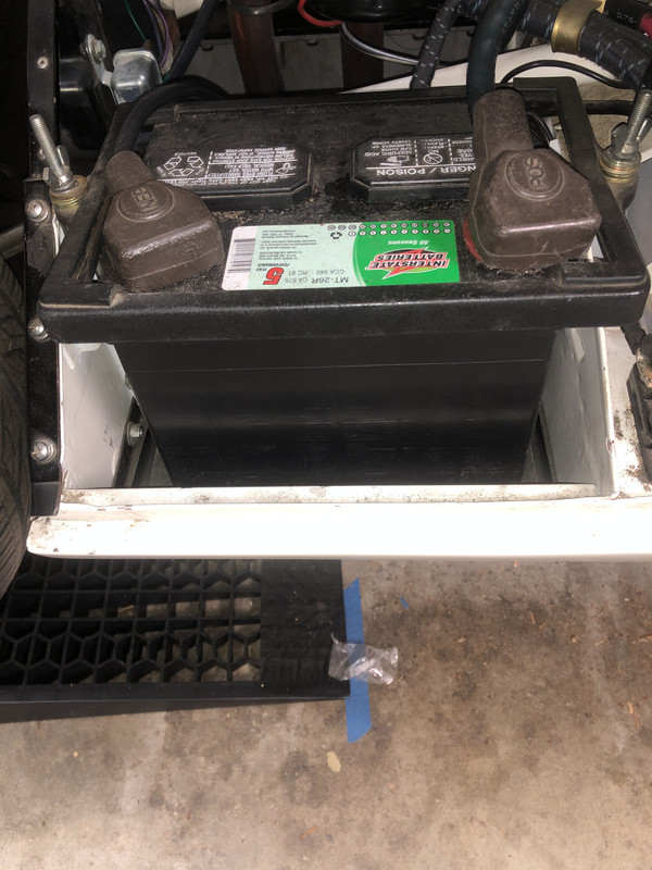

Hope these pictures post. I use a smaller form factor Group 26R (reverse polarity posts). Plenty of CCA, easy in and out with smaller size and weight, good spacing of the terminals. Not stock looking but i am not showing the car for points. Commonly available.
I think the hold down I got some time ago is a proper repro, not positive but looks close, and it just fits. Gotta trim that J hook someday.
Layne
