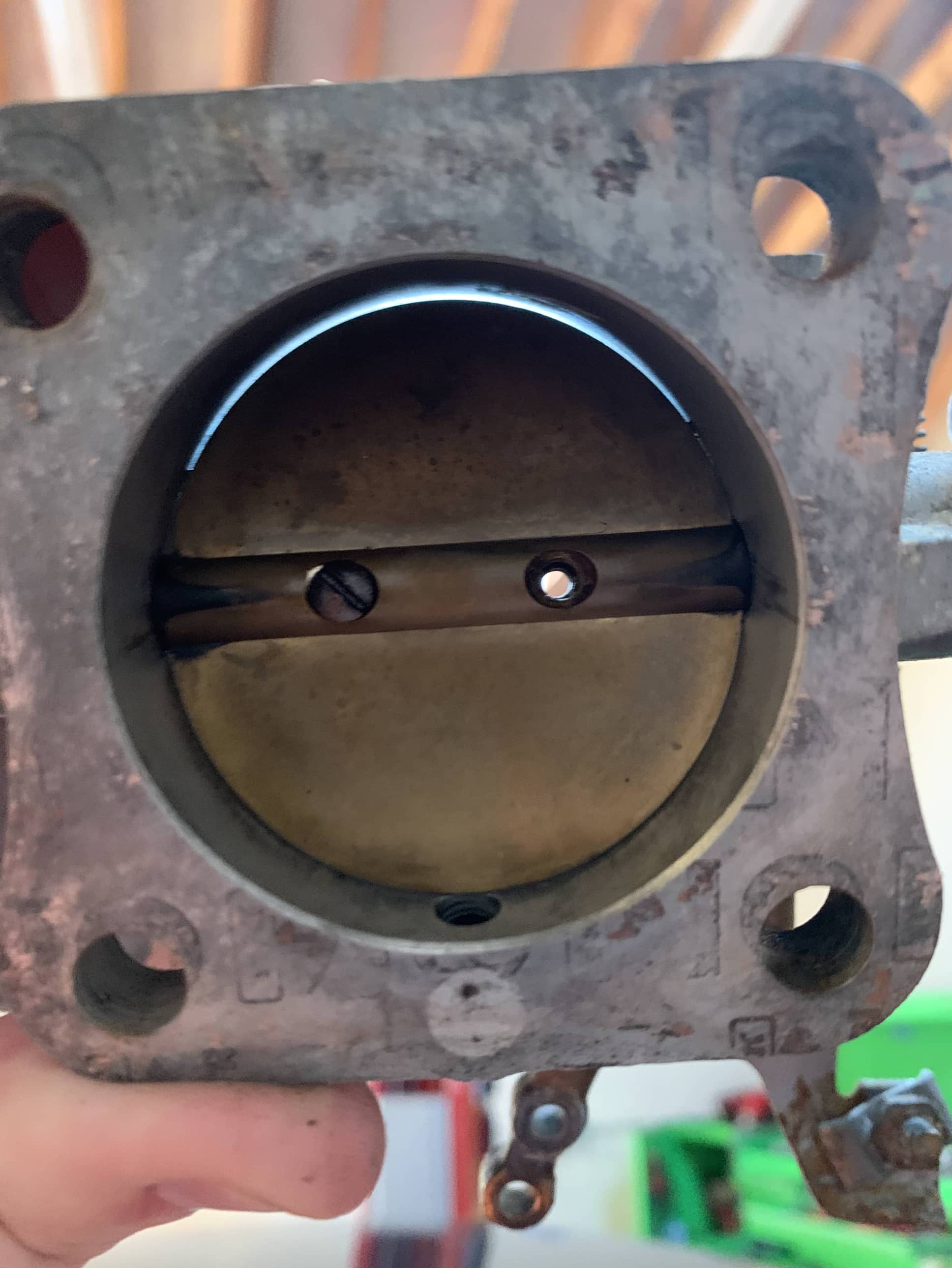

#6 Re: Idle question
Post by Gorwanvfr » Mon Jun 28, 2021 9:53 pm
Small update
I pulled the middle carb off the car this evening.
Before (don’t mind the missing screw I had removed it before I remembered I had not taken a picture)
After
Now I have to open the air bypass screw to maintain idle 8-) .
