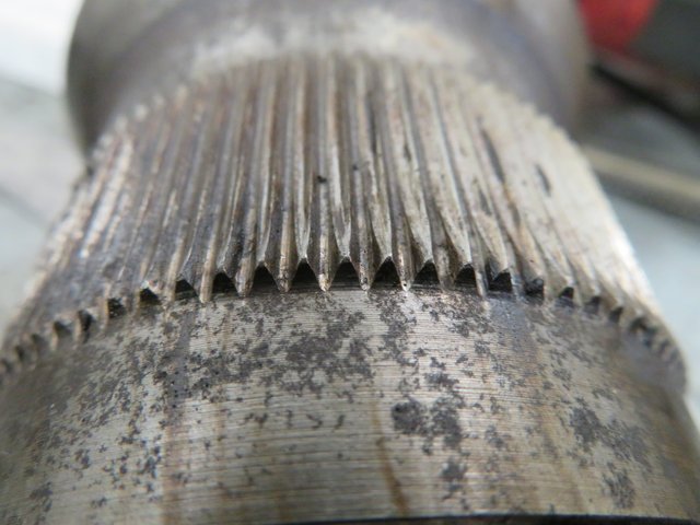

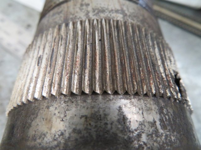

The first photo looks serviceable, as long as you can't rock the wheel back and forth (without the spinner in place), but the second photo looks like it could be a textbook example of very worn splines. Hopefully the wheels look better than the hubs or you will need to replace both.
