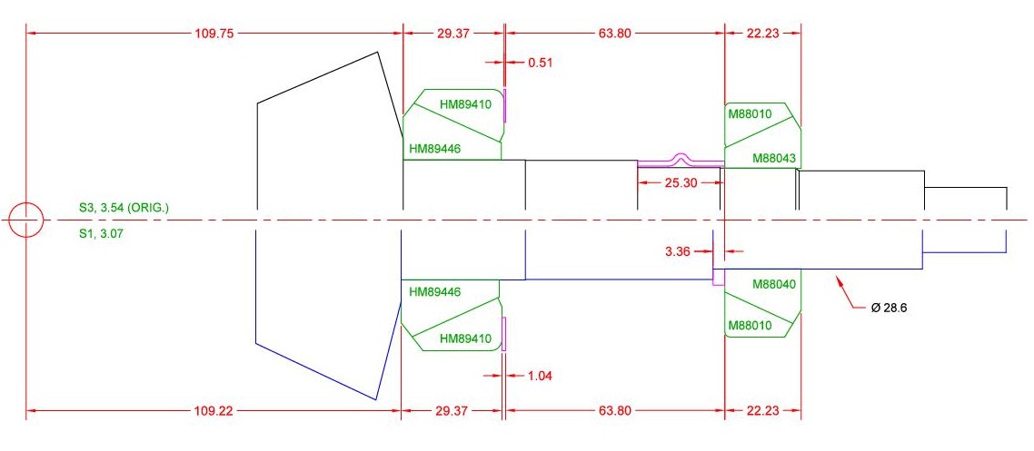

G'day Bill. Not sure how I managed to buy a S1 CWP for my S3.angelw wrote: ↑Sun Feb 24, 2019 10:29 amPrior to the introduction of the collapsible spacer, the shoulder on the Pinion Shaft that resists this spacer was closer to the Companion Flange by approximately the collapsed length of the collapsible spacer; thin shims were then used to set the correct bearing pre-load.
Quaife via SNGB product code 8825.
Here is pic of new (S1, right) vs original (S3, left). Shoulder is closer to the companion flange (position) as you describe above.
Have you ever done this, fitted S1 CWP into an S3 diff, with shims instead of crush-sleeve? I cannot see why it wouldn't work except, in addition to the shims the S1 uses a "distance washer" (short tube) that is NLA. Might you have one of these?

Yes I have; about 6 months ago. The client's S3 was equipped with a diff from an XJ6, without LSD and a 3.07:1 ratio; he wanted the LSD reinstated and the original ratio of 3.31:1. He sourced the parts and part of the package was the Crown-wheel and Pinion from a late S1.
The only difference between the S1 and S3 Pinion Shaft is the location of the shoulder that is either the stop for the collapsible spacer (S3), or distance washer and shims (S1). You won't have any problems with getting the S1 unit set up.
I haven't got a spare distant washer and I don't have an S1 diff stripped down at the moment. Accordingly, if you measure the distance from the face of the inner race of the Taper Bearing installed on the shaft, to the shoulder that the distance washer interfaces with, I'll work out what length the distance washer should be, taking into account a few shims and make you one.
#11 Re: Differential Pinion Shaft Collapsible Spacer
Thanks Bill, good news that I can use S1 CWP. It does seem to be a very economical way to convert an S3 to 3.07, S1 CWP's cheaper and more available than S3. Making a distance washer, thx very much for yr offer, i'll see how I go myself 1st, by boring out a 3 mm thick washer to 28.7 mm. Here are my dimensions fyi. Seems the only difference, apart from shims instead of crush-sleeve, is that a different outer bearing cone is req'd.
