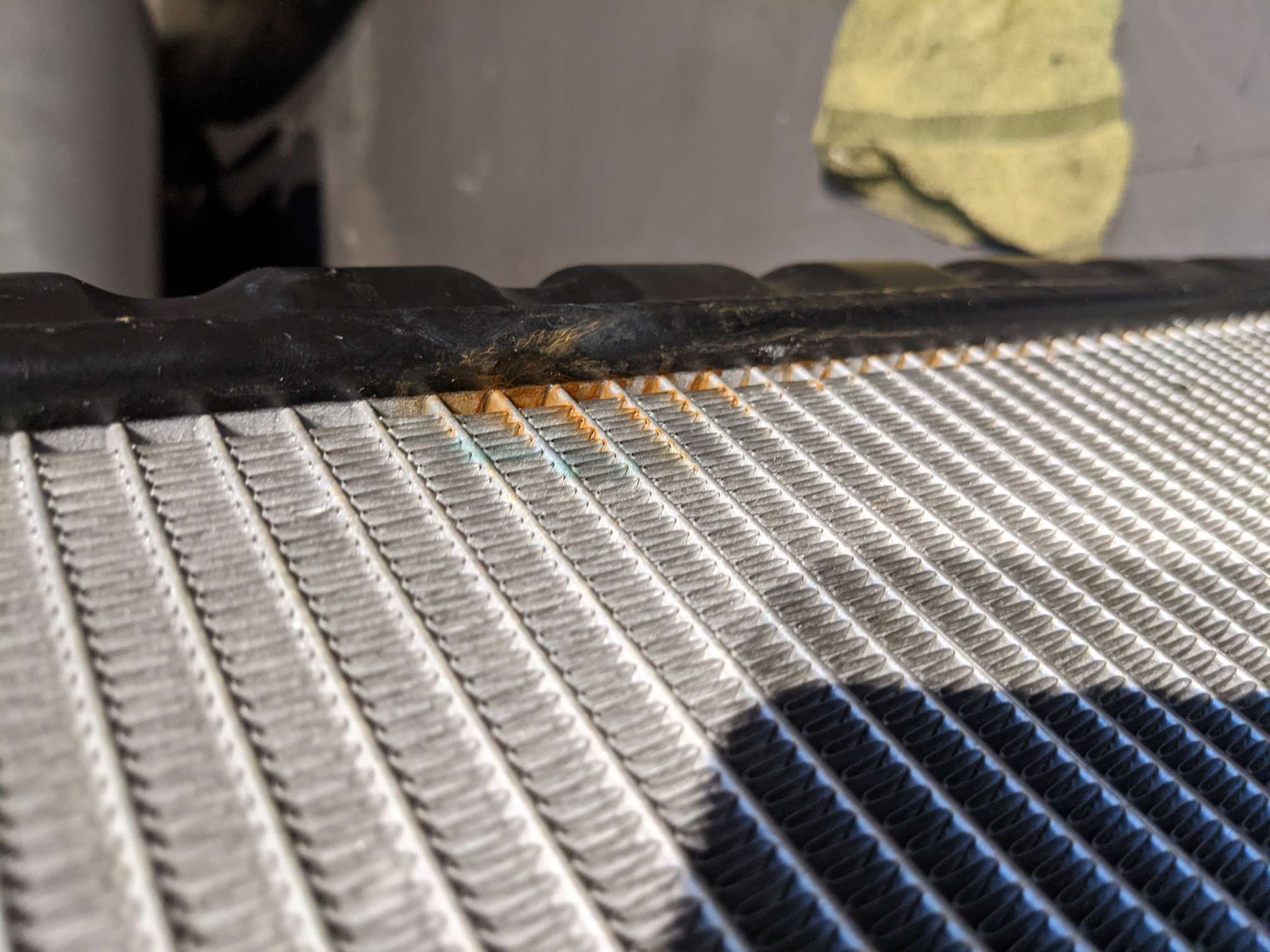

My 3 year old Fosseway rad has sprung a leak halfway up one side between the finned core and the side section. I discovered a large puddle on the floor, the bottom "tray" section of the rad was overflowing, and drips coming off the LHS bottom bracket (that secures the cowl) about 2 per minute. That's with a cold engine. So I drained it down and managed to remove the rad. What an unspeakably horrible job when the bonnet is on :sad:
It's not clear exactly which joint has failed not whereabouts on the joint (there are brown deposits front and back, running downwards).
Simon at Fosseway is apologetic but explained that it can't be soldered as it's aluminium. He suggests that:
- I pinpoint the leak exactly (not easy as it is lurking somewhere behind those finned bits)
- clean the area round the hole thoroughly (again, doesn't look at all easy)
- apply araldite and leave for 24 hours (really???)
I have zero experience of patching up blown rads and have v little confidence that this would be a durable and permanent solution.
It was hard enough getting the rad out singlehanded, and I dread the thought of doing a bodge repair, refitting it, and finding it hadn't worked. Or finding it works for a while until it stops working on a hot day far from home. (I've already had a leaking SS header tank with a bad soldered joint from Terry's Jag so I'm getting bored of cooling problems and mopping up recurring puddles of antifreeze on the floor....)
Its a lot of dosh but I'm wondering whether I should just buy a new one and see if he will give me a bit of a discount for goodwill. I believe Fosseway products are generally good and reliable so this whole thing is super-disappointing.
Please, anybody have any experience or advice to offer?

Hi Jeremy just had a really nice Ali fuel tank made by Ailcool....great guy Terry runs the place...very clean,neat, tidy setup with very nice products......worth giving them a call re repair or to make a replacement.....Steve http://www.alicool.co.uk/index.html
#3 Re: Can I fix a leaking radiator with araldite?
Posted: Sun Jul 18, 2021 8:51 pm
by christopher storey
Forget al2 radiators for this very reason : the slightest damage to them and they are irreparable

Thanks Steve....anyone else had any experience with Alicool? Significantly cheaper than Fosseway.
Christopher, your comment is sobering. I thought everyone was replacing old rads with aluminium ones because of the superior heat dissipation. Are they inherently more prone to damage or failure, or just impossible to repair?

Jeremy : I don't think they are more prone to damage although the alloy tubes are very thin. The problem, according to the radiator repairers that I have used ( and one of them had a scrap pile of alloy rads that would have done credit to a scrapyard ) is that there is no practical way of repairing or even sealing damaged tubes, unlike copper which can be soldered with ease if you have the right equipment

I'm not saying it would be easy or even possible, but would it not be worth trying to weld the leak place with this type of low temperature welding rods:
https://www.welduk.com/product/aluminiu ... UBEALw_wcB
Others are available. This is not actually welding but more like soldering as when the base alloy gets up to the melt temperature of these rods they actually dissolve the surface of the aluminium and create a very strong bond. I made an ally silencer for a model plane petrol engine using sheet alloy and an inadequate base silencer to fit the engine. It is necessary to break through the oxide layer on the surface of the alloy (which is what gives it its corrosion resistance) to start this off which is why a wire brush or SS rod/wire is used to scratch the surface first.

Afraid the aluminium welding rod Jerome mentions, while able to join aluminium sheet together well with practice, will be impossible to use on radiator tubes. You need to raise the temp of the aluminium to be joined to close to its melting point....and On thin tubes with a torch (a soldering iron never gets not enough) you will melt the tubes rendering any repair impossible. i have the rods and have dabbled with welding Al. It can be done but is far from easy!
Araldite may effect a temporary repair but for me the only solution is a new core...there is a place at Bicester heritage that could recore....possibly in brass (radiator cores were never pure copper as far as I know)...or bite the bullet and buy a new rad.

You could try Barr's Leaks - the Factory put two bottles in each car on the production line.

Worth a look? JB Weld aluminium rad repair…
#10 Re: Can I fix a leaking radiator with araldite?
Posted: Mon Jul 19, 2021 2:17 pm
by malcolm
I've used that on a boat to stop leaks. works well. Make sure you use disposable gloves, its a bxxxxxx to get off your skin. Sticks to anything though. Have to use it quite quickly once you've rubbed the two parts together.

I'd refit rad and then K seal is your friend

Many thanks for all the constructive responses! Simon at Fosseway did offer a replacement rad at a modest goodwill discount but it was still going to be expensive and delivery 4 weeks off. And once bitten twice shy...
So..."who you gonna call?" Yep, Jeremy gonna call Angus. Upshot: I ordered a new rad from RadTec - a supplier he has long experience with and total confidence in. Darren Field at RadTec was not impressed with the Araldite idea to put it mildly.
AND he had one black powder coated 4.2 S1 rad in stock, AND he dispatched it this afternoon, overnight delivery.
