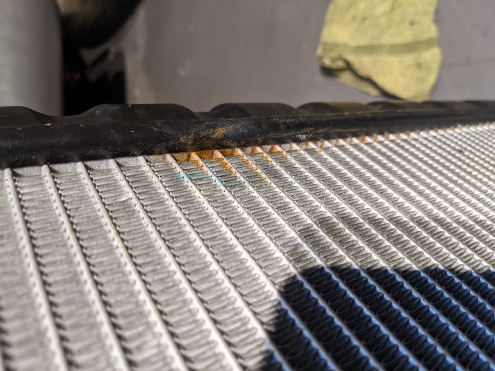

Help please!
My 3 year old Fosseway rad has sprung a leak halfway up one side between the finned core and the side section. I discovered a large puddle on the floor, the bottom "tray" section of the rad was overflowing, and drips coming off the LHS bottom bracket (that secures the cowl) about 2 per minute. That's with a cold engine. So I drained it down and managed to remove the rad. What an unspeakably horrible job when the bonnet is on :sad:
It's not clear exactly which joint has failed not whereabouts on the joint (there are brown deposits front and back, running downwards).
Simon at Fosseway is apologetic but explained that it can't be soldered as it's aluminium. He suggests that:
- I pinpoint the leak exactly (not easy as it is lurking somewhere behind those finned bits)
- clean the area round the hole thoroughly (again, doesn't look at all easy)
- apply araldite and leave for 24 hours (really???)
I have zero experience of patching up blown rads and have v little confidence that this would be a durable and permanent solution.
It was hard enough getting the rad out singlehanded, and I dread the thought of doing a bodge repair, refitting it, and finding it hadn't worked. Or finding it works for a while until it stops working on a hot day far from home. (I've already had a leaking SS header tank with a bad soldered joint from Terry's Jag so I'm getting bored of cooling problems and mopping up recurring puddles of antifreeze on the floor....)
Its a lot of dosh but I'm wondering whether I should just buy a new one and see if he will give me a bit of a discount for goodwill. I believe Fosseway products are generally good and reliable so this whole thing is super-disappointing.
Please, anybody have any experience or advice to offer?
