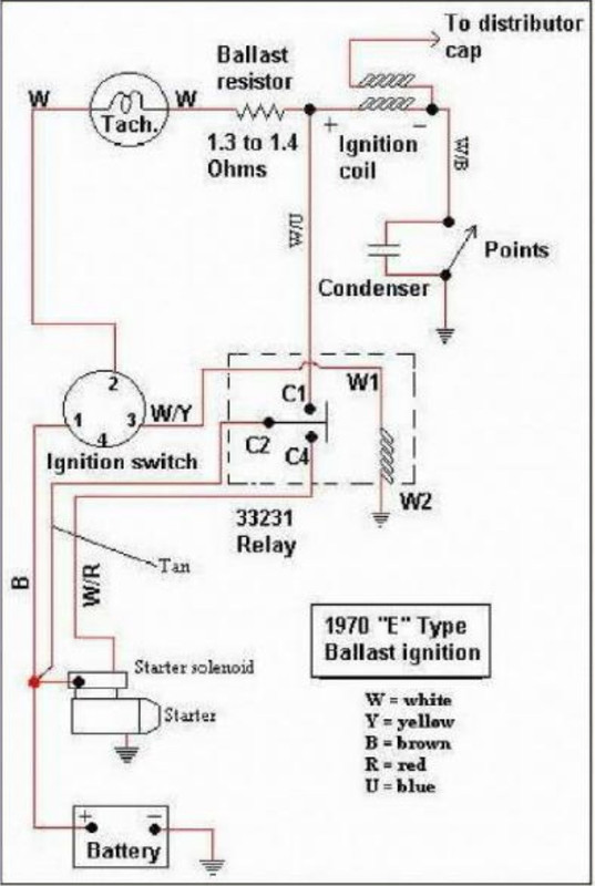

Hello
I wondered what your thoughts was on the Ballast Resistor fitted to later S2's. I removed mine years ago.
I have just had the engine rebuilt and I am in the process of connecting everything back up. I have just noticed that I still have the White Blue wire connected from the starter solenoid to the + on the coil. This connection was used to bypass the ballast resistor during starting.
I am confident that as I no longer have the ballast resistor I can remove this connection from the relay / coil, that would leave me with just the 12v coil feed coming via the tachometer as in non-ballast cars.
My question is, what do we prefer. Ballast or Non-Ballast, I have a modern starter and 123 ignition fitted, I'm thinking that the ballast resistor is not required. I have all the parts to put the resister back if required.
I know that the 123 electronic ignition needs a minimum of 1ohm coil resistance, my next job is to check this.

Ballast resistor systems were introduced to improve cold starting and to minimise unburnt fuel whilst trying to pass those all important emissions certifications.
The ballast resistor and coil came as a matched pair so if you remove the ballast resistor you need to change the coil accordingly.
Modern electronic ignition systems give the benefit of good cold starting without needing a ballast resistor setup.
If you've got an electronic ignition system then removing the ballast resistor is the sensible thing to do as long as you change the coil at the same time to match your electronic ignition system.
By removing the ballast resistor you improve reliability by removing two components that could fail (resistor and associated bypass relay) and allow energy otherwise lost in the ballast resistor to be used by the new coil to give you the best possible spark at all times, not just when starting.
Having said that, if you leave the ballast resistor in place as Ash has done everything will still work a treat. Your rev counter should be unaffected either way.
Ballast Resisters were in use long before emissions certification was an issue. Some systems simply used a Resister Wire.
In quite lay terms, as the starter motor begins to crank the engine, it causes a significant drain on the battery. The ballast resistor allows the ignition system to operate at a lower voltage until the engine starts. After ignition, the alternator begins to recharge the battery, restoring the regular voltage. The ballast resistor then functions to regulate the voltage going to the ignition system to avoid damage to the system.
Many electronic ignition systems take care of the same process the Ballast resister is used for and therefore, the Ballast Resister can be omitted from the circuit. For example, of the two Fireball ignition systems, the XR700 and XR3000, the XR3000 doesn't require a Ballast resister, but the XR700 does, depending on the Primary Coil resistance of the coil being used. A coil with an internal Ballast Resister will have a resistance of circa 3-4ohm, in which case, if used with the XR700 unit, the external Ballast Resister can be omitted (by-passed). The XR3000, takes care of what the external Ballast resister does and therefore, a low ohms coil should be used.
Accordingly, the coil choice and whether a Ballast resister is required with the ignition system being used is an important consideration.
There are some misconceptions here.
The ballast resistor ignition is not there for emissions purposes, nor to operate the ignition at a lower voltage until the engine starts and it doesn't improve cold starting either.
A car engine is much more difficult to start than it is to be kept running. To provide optimal coil recharge during normal running conditions AND allow for the increased effort needed in starting, the ballasted igntion was invented. This dovetails with the coil and the starter relay to allow full voltage to be applied to the coil during starting but only a reduced voltage to the coil at all other times.
It is there to limit overcharging the coil during normal running conditions, so the coil specification has to be matched to the ballast resistor being used. During starting the coil is fed full voltage, which it can take for a short time, but this would lead to overheating if persistently overcharged. The plug wires and plugs also don't want to be overstressed needlessly.
Electronic ignitions need to be wired in accordance with their manufacturer's instructions. Their electronics are designed to take this into account and the coil specification needed to be used is part of that.

A diagram here to show whats being discussed.....Steve
Steve
